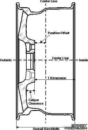

To understand how the position of a wheel shifts within the fender as offset varies check out the following diagram:
As positive offset increases the wheel moves further inside the fender. Conversely, as positive offset decreases the wheel is pushed further toward the outside of the fender.
I hope that helps. Wheel offset drives me nuts too.
