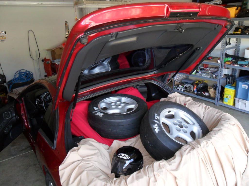

-26x10.5x16 ET streets (previously BFG g-force sport)

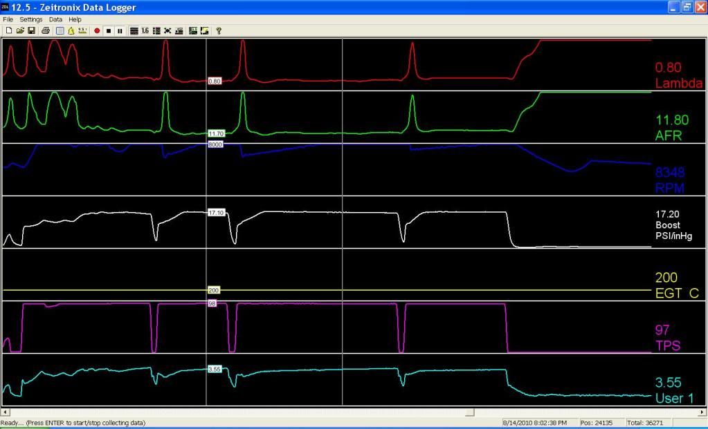

I put 6 gallons of 100 octane gas in my empty tank on the way there and slowly raised boost all night while logging my air fuel ratio to be safe. Around 17psi I found that first through third gear were ok but in fourth I hit as high as 12.4

Next time I hope to have a custom dyno tune. Here's what my off the shelf tune looked like with 100 octane and 17psi. No egt sensor and user 1 is the output voltage of my apexi neo. (Keep in mind, I am using launch control which cuts spark at the start)
