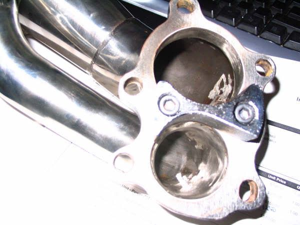

First impression was very good. Nice and shiny, the o2 sensor thread came with a cap which was not included in the SZ one I bought.
Second look I already had some concern over the 5 bolt flange, circled in red.
The welds are good, flange is thicker than the SZ counterpart. The flange is also welded all the way through unlike the SZ unit which has spot welds. There is 1 less weld on the body of this dp than SZ's one. How big of a difference that makes I do not know.
When I took this to my welder friend he laughed at me when I pointed out the flange holes. "Cheap china sh*t bro" :/
He then pointed out a few things to me while still laughing with hilarity.
He pointed out the copper brown colour of the dp to me which I never noticed before, and explained to me that these must have been electroplated (rather badly he added). He then went on saying these are most likely made from a cheaper grade of mild steel, plated to look like stainless steel. He told me he has never seen that done in his 35 years of metalwork.
The 3 bolt exhaust flange is no better, circle in red again you can see how close the holes are to the edge of the flange. My friend said these must of been drilled manually with a template (so hole distances are the same) but that is about it as far as precision goes.
The separator which is held on by 2 studs is pathetic. To accommodate the stud head they drill a smaller hole over the bigger hole. NOT PRECISE AT ALL.
I don't have a picture of this but you can easily imagine it, my friend traced the triangle and the 3 circles on paper, and then placed the other dp over it. The triangle/bolt holes are no where near inline.

As mentioned before; main difference is the flange not being as thick (not thin by any means), the 5 bolt flange not welded all the way through, O2 sensor cap not included and 1 extra weld on the body.
The 5 bolt alignment. Note the irregular size holes and clearance to the edge.
The two pics below are not from me, first one is SZ and second one is AMS. Note the brown copper plating I talked about. You can tell the two uses different materials.
My separator did look better than the one on the top pic. It was however still not CNC machined or anything if I recall correctly. Seems like both AMS and SZ separators can be a hit or miss as far as quality is concerned. I am sorry but I forgot to check how the studs are held on the SZ one (not sure if its another case of smaller drill hole over a larger one).
