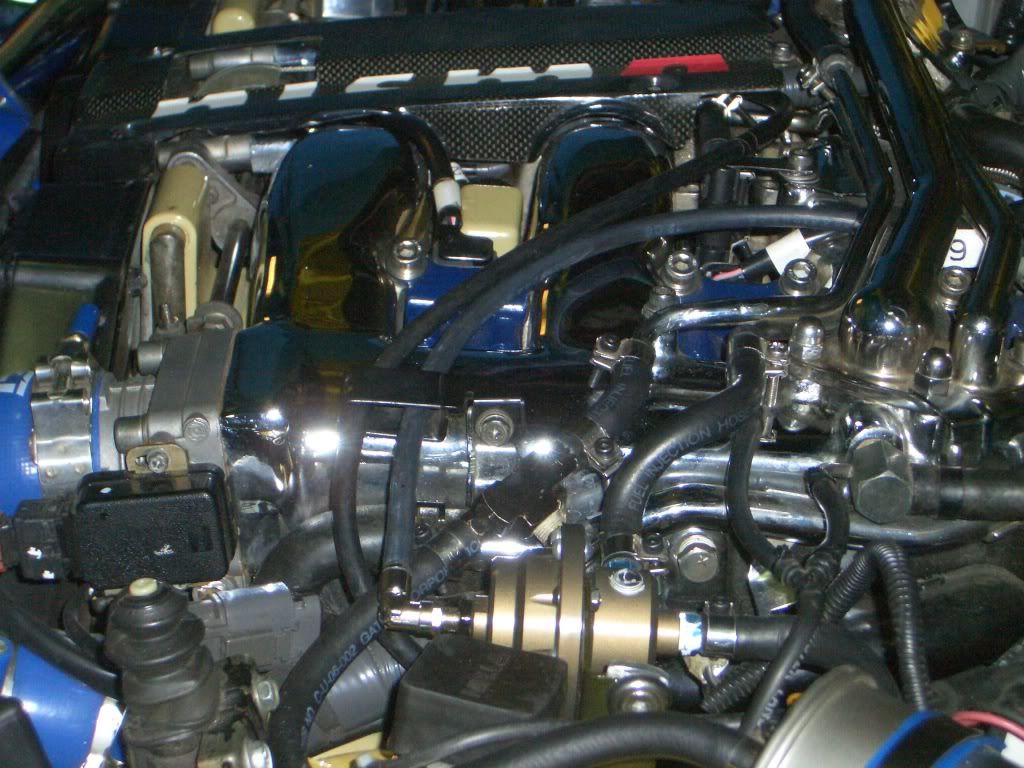

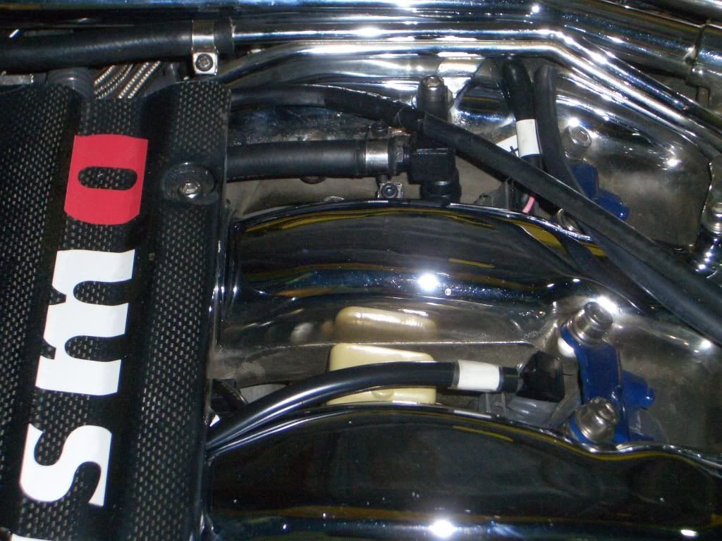

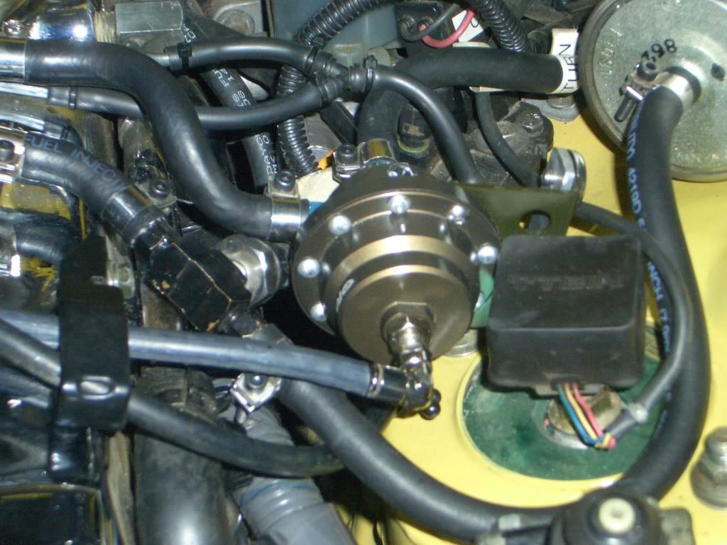

No need to remove dampener or make changes to fuel routing
just fab a U fitting to replace OEM FPR

Re: Re: install pic request
ouikikazz
20:02:24 07/01/10
Dampener is need to counteract fuel pump pulsation (n/m)
