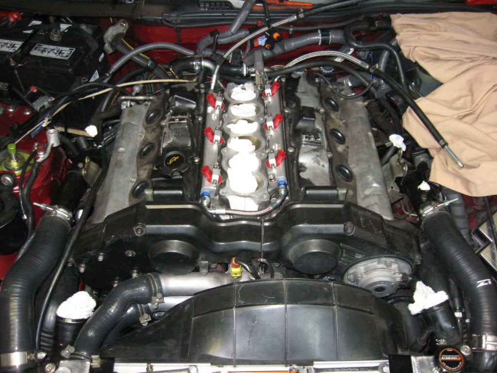

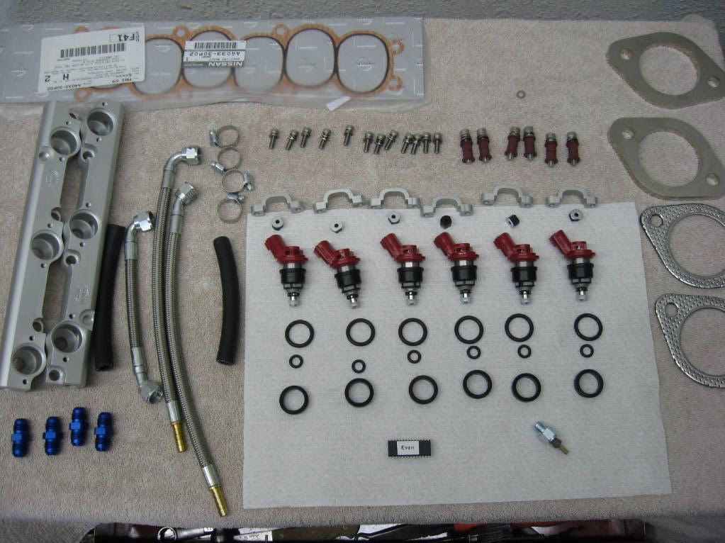

I know it's not the greatest looking bay...

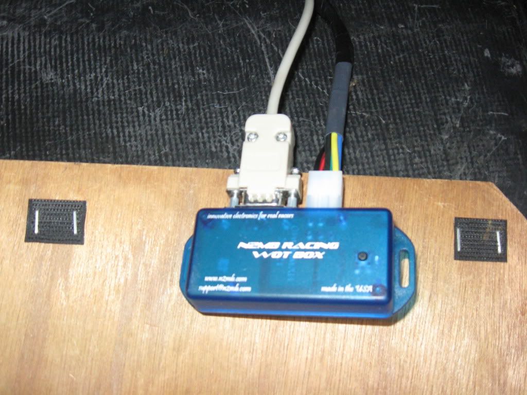

Ive also installed the Wot Box into my car. For those that don't know it is just a simple launch control with full throttle shifting. I have a pretty thorough install writeup put together but decided not to post it. The full throttle shifting works well and I like how the launch control cuts spark and not fuel. However, with my stock turbos and my ebc set to 14psi I have only been able to build a steady 9psi. From what I've heard other units like the gizzmo, import intelligence and techtom are a bit more capable so I have held off on posting the writeup.

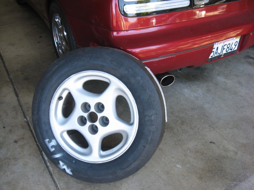

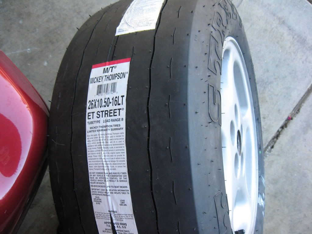

In addition to the Wot box I decided to purchase a set of ET Streets to go on some spare wheels I had lying around. Can't wait to test out the new tires.

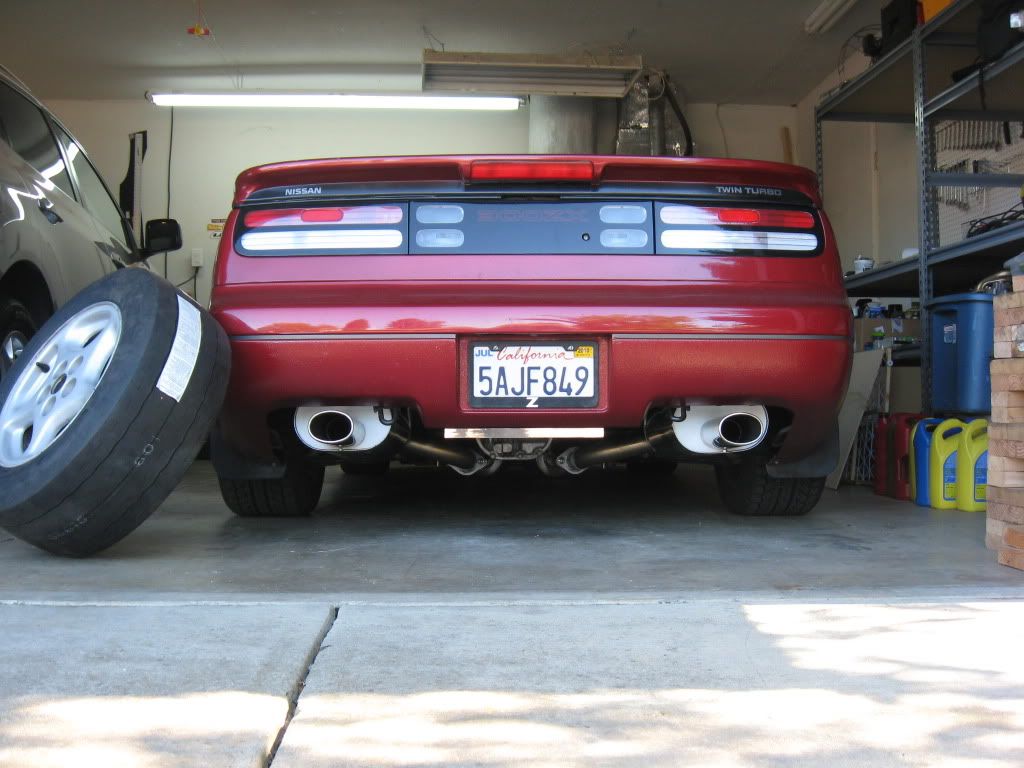

Lastly, after a long period of contemplation I decided to swap out my SZ cat back with another forum member for his JWT genie cat back. I love the look of the SZ's but wanted something a tad bit quieter. I'm content with the trade so far. Thanks Steve!
