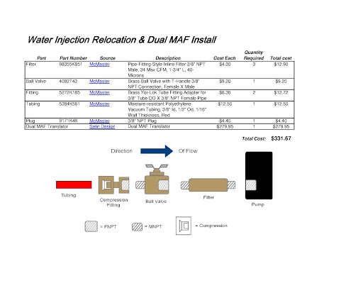

So I'd tap the OEM washer tank in the back, probably use a bulkhead fitting in the bottom of the tank. I'm going to drill a hole in the wheel well, or just in front of it to run the polyethylene tubing down along the OEM HICAS line location. Snake it up and around somehow to the front of the car, where my water injection pump lies. I'll have all the stuff shown above before the pump to prime/protect it.

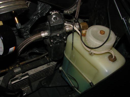

My pump is probably different than yours, as I have the SMC kit, and you have the Snow Performance unit. Nope, I'm wrong, we both have the same kit, just checked. Does yours look like this?:
If so, I can keep you up on what changes/adjustments I did during the install.
