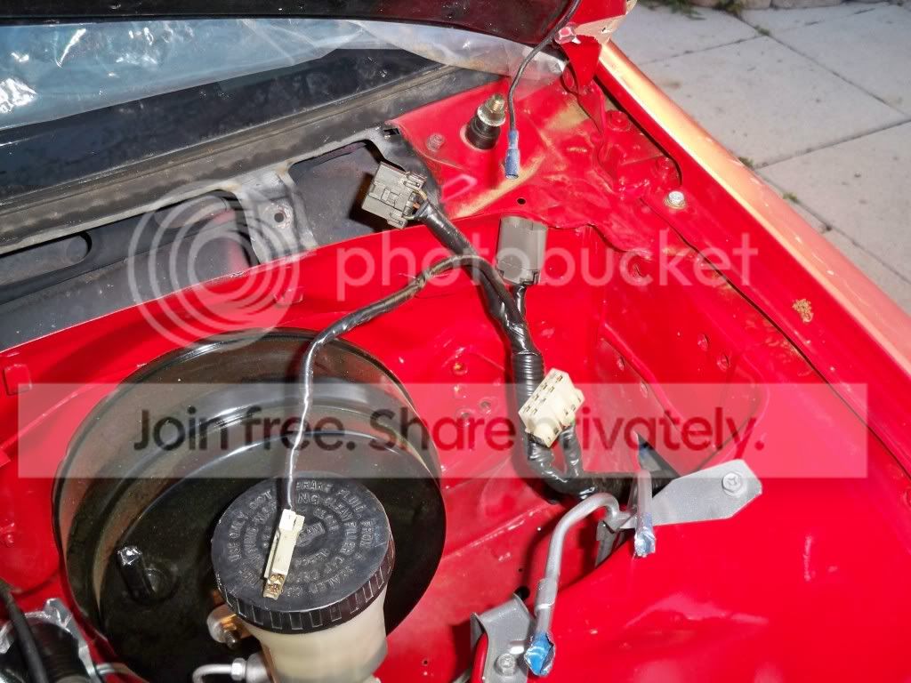

Message In an attempt to further clean up my engine bay before engine installation i wanted to get rid of a few wires hangin around my d.side firewall ( wiper motor wiring, break fluid level wiring ect . ) and thought id share . This may have been done before but a search returned nothing .

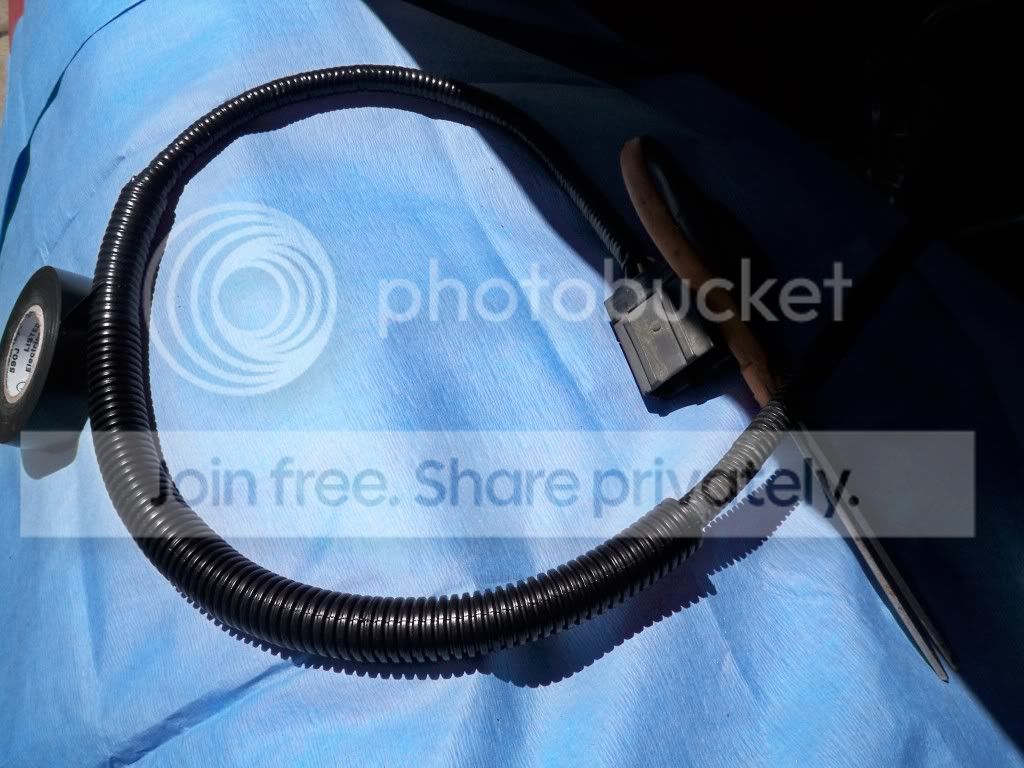

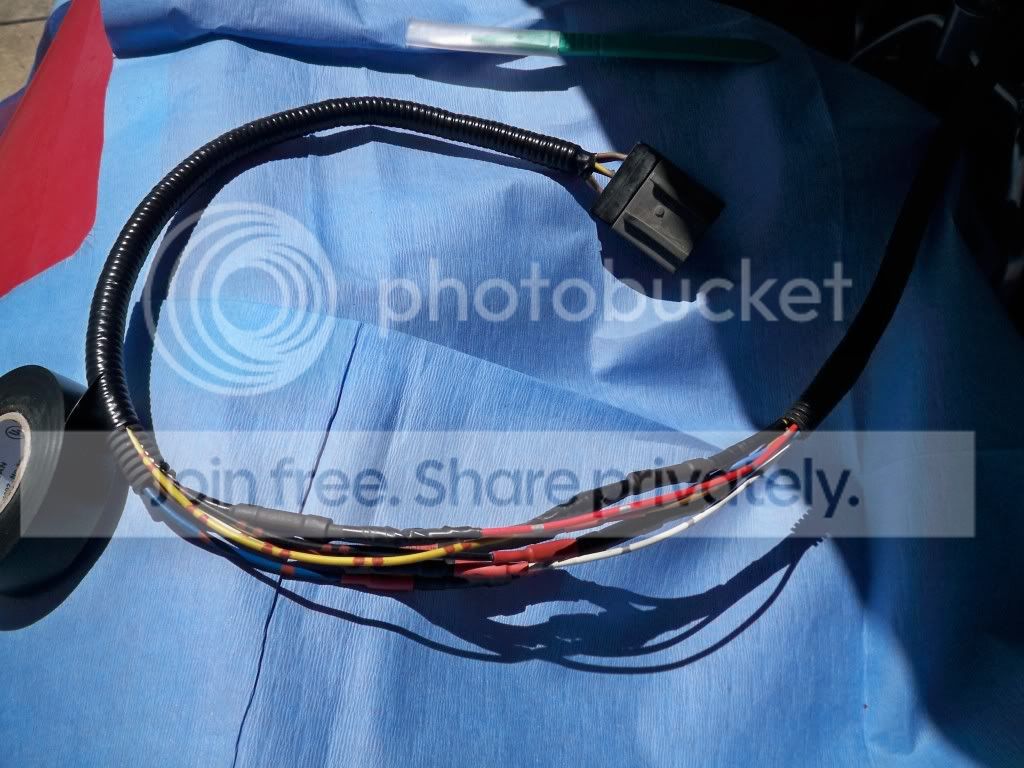

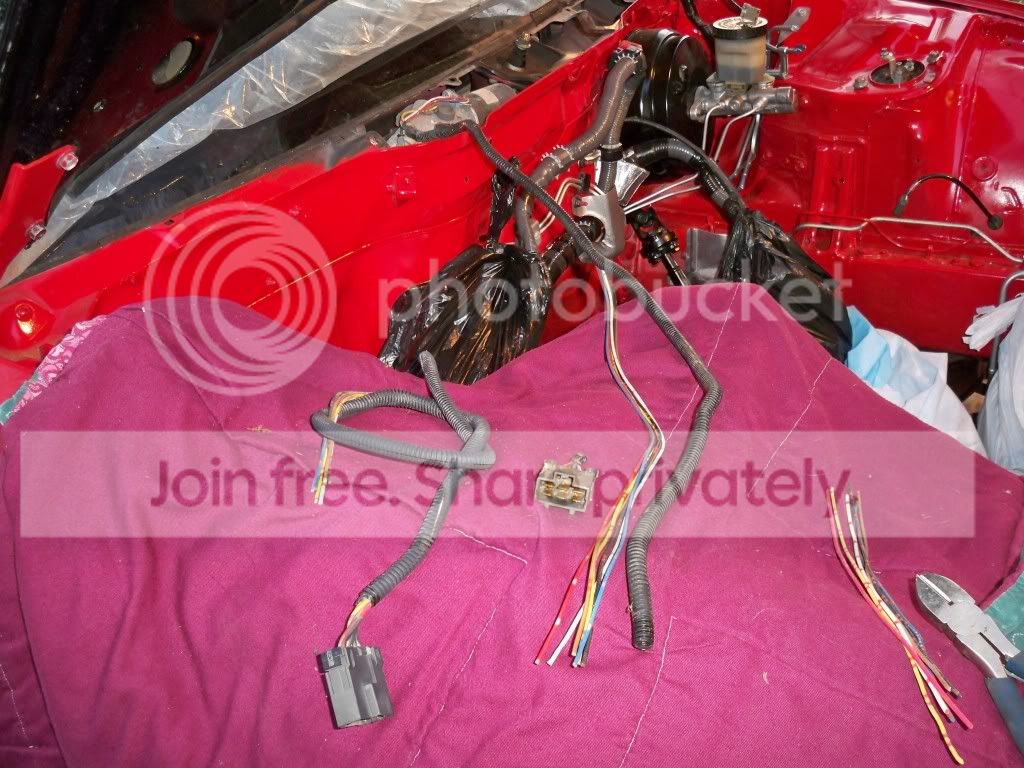

First i had to borrow some wiring harness and plugs from my donor z to extend my wiper motor and break fluid level wires
Soilder , crimp ,heat shrink , tape, loom ,tape

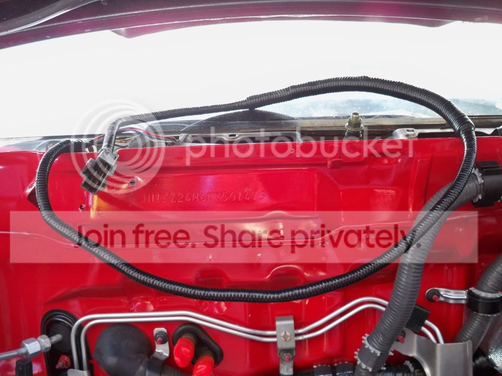

wiper wires were extended 14 inches.

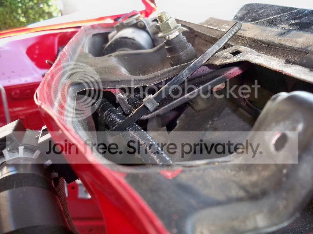

Then run on the inside and tie straped up away from the wiper arms
out the drain and straped high away from drainage

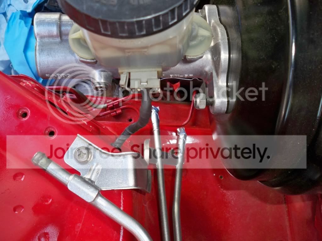

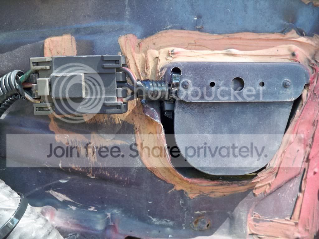

next i cut and extended the break fluid wiring and ran it through the fender
all holes were painted and groumets inserted.

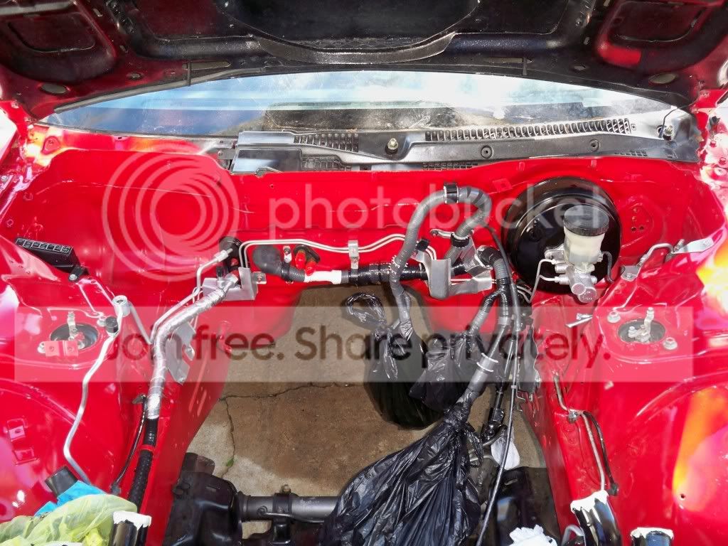

Final pics VVVV
And yes I know there are bolts loose and things out of place for now , but try to focus on the wire tuck :) Thanx
