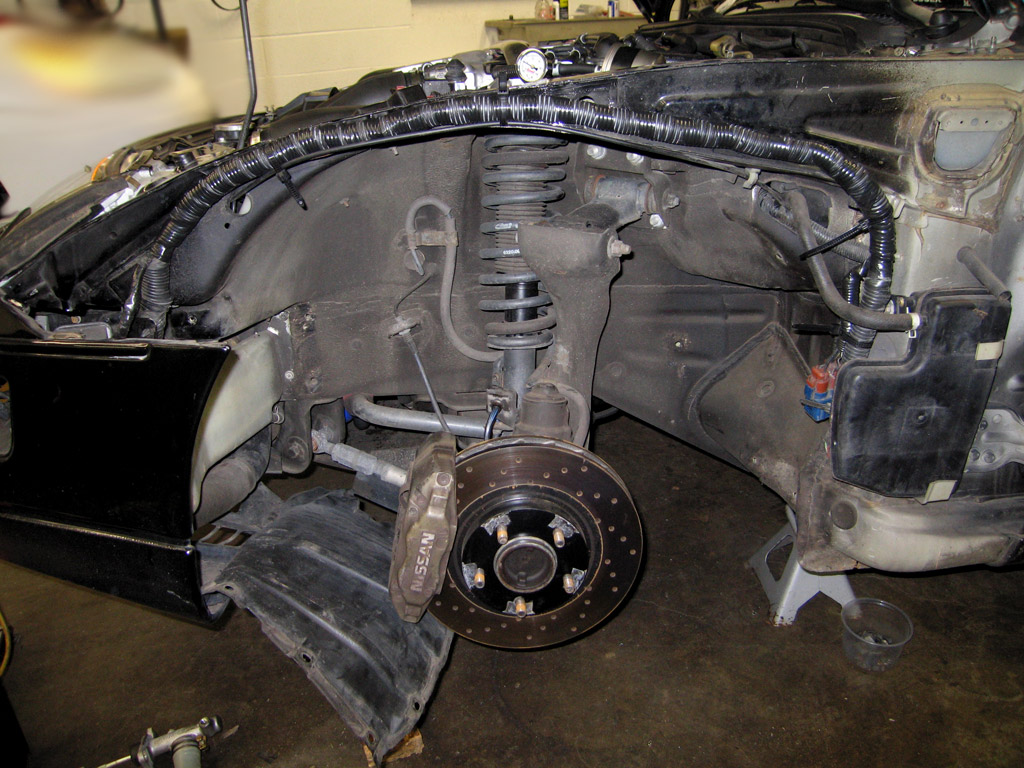

A little history: before I owned the car, it was smacked on the DS fender, powerfully enough to bend the tension rod and cause a need for a body weld in the engine bay that's clearly not factory over the wheel. Bernie came to the theory that the large body harness that runs through there got compromised by that accident and the solution would be found there.
Several years ago we were in there and found an obvious crush point. We checked all the wires in that area, cleaned up anything that we could find, and re-wrapped the harness cleanly. At that point, we were chasing down a mysterious brown wire that was running by itself through the engine bay, replacing it and running it under the fender along the stock harness.

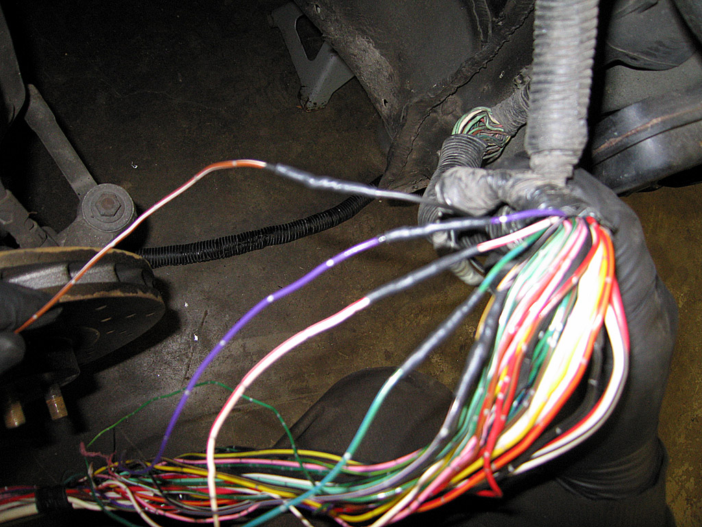

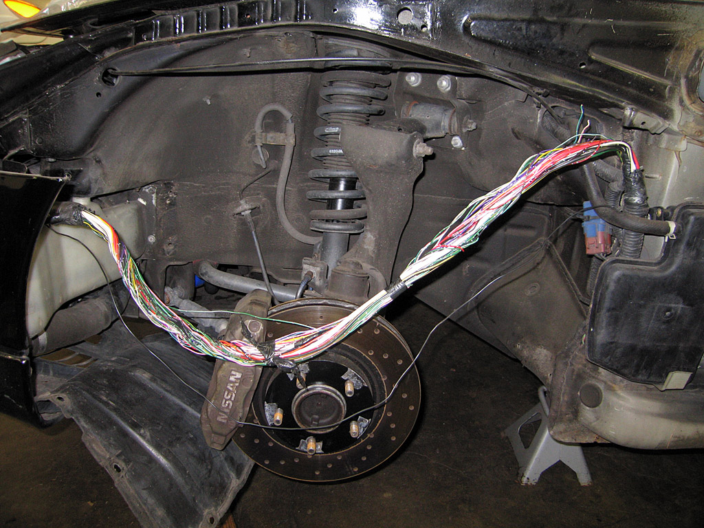

Back to the present: last night while waiting in the garage for B, I stripped off all the tape and protective plastic tubing from that long stretch of body harness. The wiring in there looked pretty good and factory-wrapped, but I kept going anyway, determined to find, if nothing else, the cause of no reverse lights.
Finally:

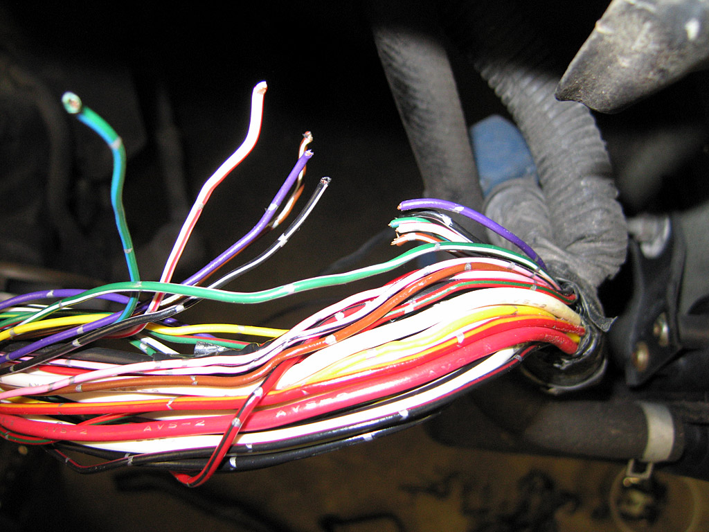

You may notice the bent-back, sharp-edged bracket above those wire ends there. We checked the corrugated tubing where it had been on that section and found holes in it.
Yep...
We soldered those wires back together. One of them was brown; big surprise. We reunited it with its proper ends so it's now running with the rest, protected.
Then, the moment of truth. Turned the key to the first position and put it in reverse: "We have lights!"
