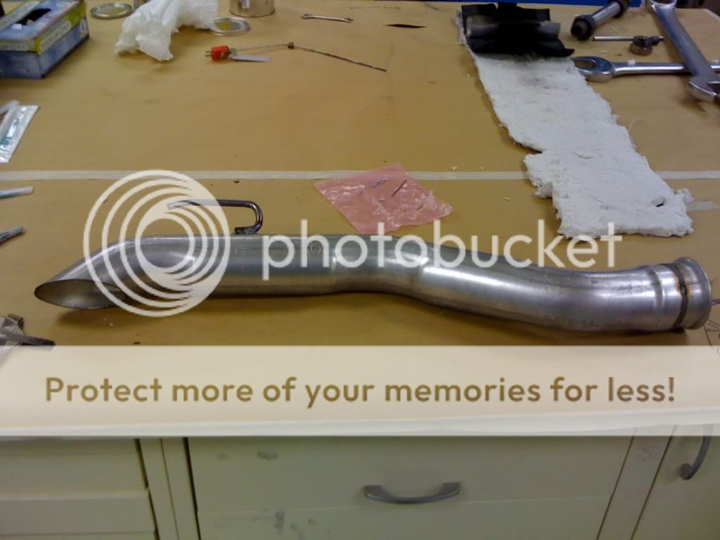

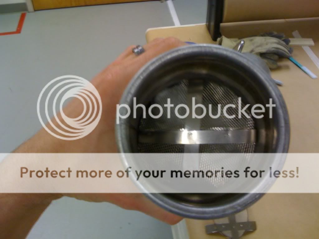

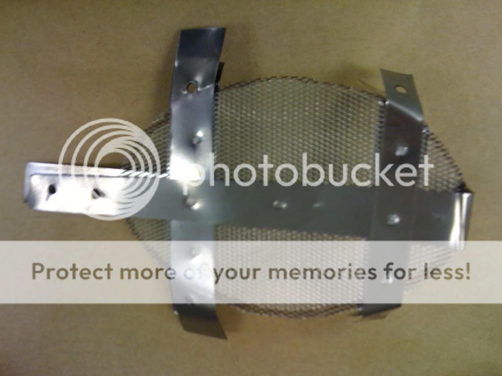

The Z (350) was meatballed twice for breaking the sound limit of a measly 92dB. Thankfully, my exhaust is v-band clamped into sections, so I was able to remove the catback "megaphone" piece (see rocket launcher picture) and install a 3" pipe that we had ginned up at the 11th hour. I packed it with some fiberfrax (silica and alumina fibers), then spot welded a nickel screen over the end and cinched it down with titanium sheet metal. Wa-la! 89dB (and a noticeable loss of power - bah!

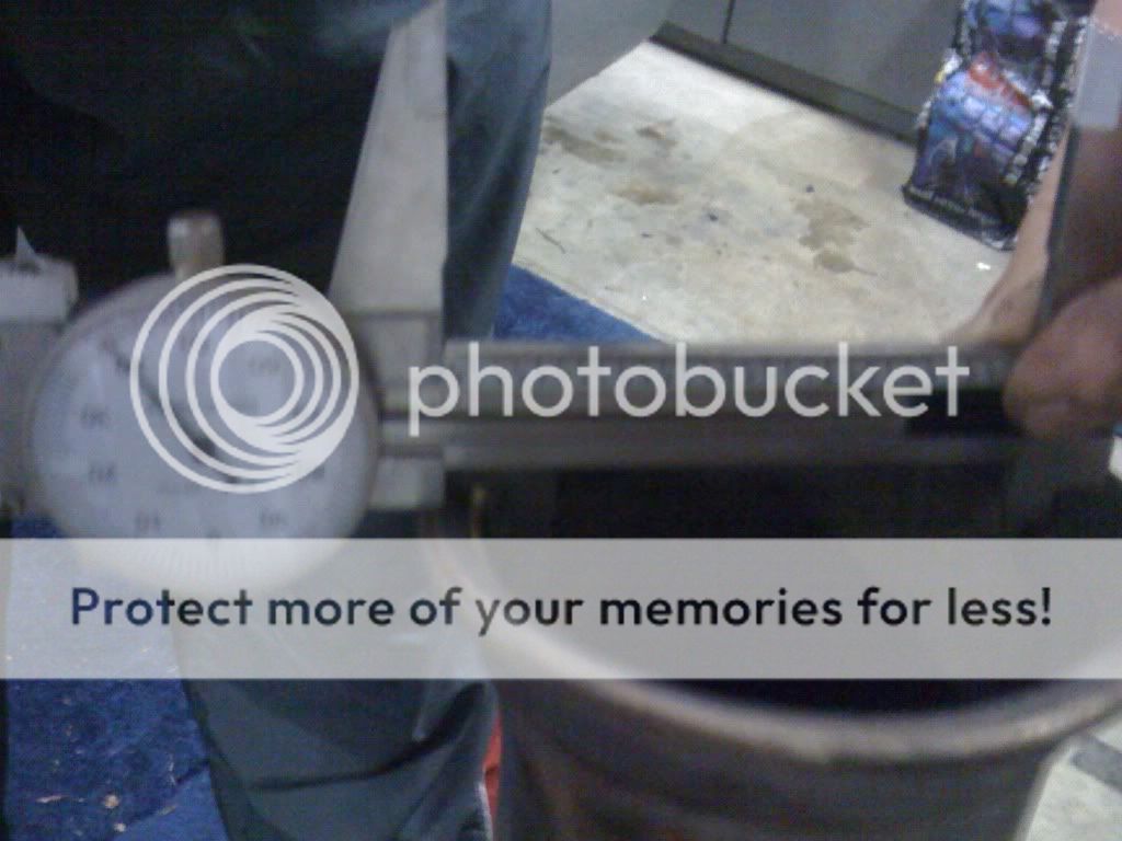

Violation #2 - time to change out the catback portion and do a sound check:
Megaphone rocket launcher removed:

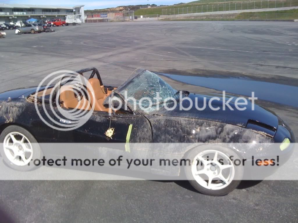

Two cars had major issues. An S2000 went into the tire barrier at T5, but was able to hose itself off and drive home. This Miata lost it at T9 and wasn't so lucky. The driver had his pride hurt, but that was about it.
