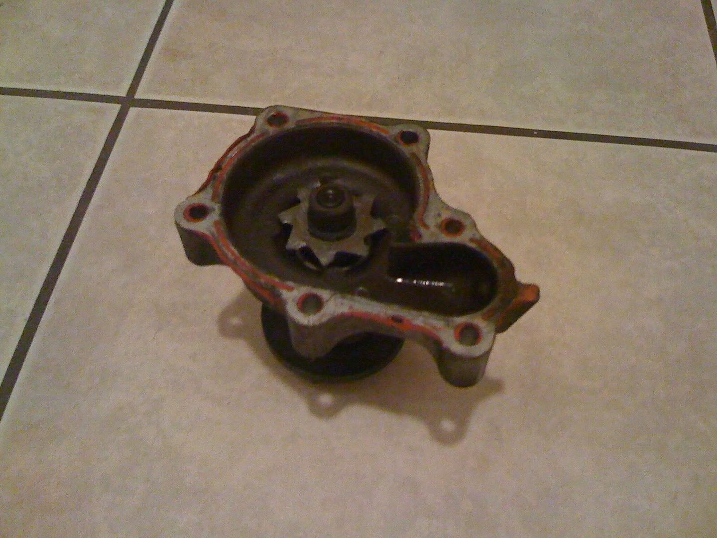

Opinion ASAP. Water pump comparision.......
posted by LivinTheDream
on January 20, 2010 at 07:23 PM
OEM or not it doesn't look like there's anything wrong with it.
If your water pump was causing overheating (and there's no shaft play or anything), this is what it would look
like:

If It fits and lines up use it a water pump is a water pump (n/m)

Not really - there are plenty of non-oem water pump failure

liquid gasket wasn't OEM
jkeyser14
20:17:27 01/20/10
i'm pretty sure liquid gasket was used by the factory
ali300zx
20:30:07 01/20/10
Original assembly liquid gasket is black not red. (n/m)
21:11:24 01/20/10
in addition to or instead of paper? (n/m)
KasbeKZ
22:43:28 01/20/10
No paper; that was on the Z31, but it fits the Z32. (n/m)
Stadsport (PHX)
00:21:08 01/21/10
I pref. the paper gasket, but you should never use both.
12:22:39 01/21/10
I've seen the red liquid gasket on most original h20 pumps
Ashman2k2
15:22:02 01/21/10
How do you know it was the original gasket on the JDM? (n/m)
08:16:09 01/22/10
Considering I've seen the same on more than 2
Ashman2k2
15:52:39 01/23/10
Use the new OEM Nissan pump. Aftermarket units have been
