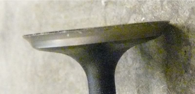

Here's one of the valves that came out after 175000 miles:

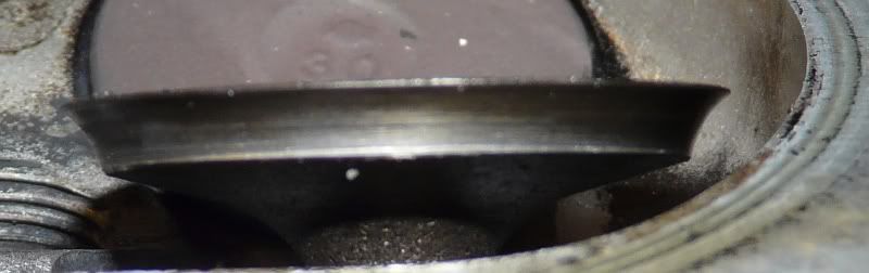

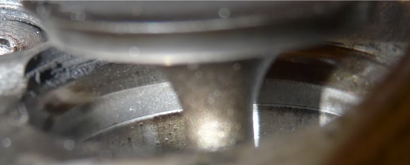

Now the only valves that are worn out are the three that were
replaced, and I've only put about 500 miles on it. Both the
valve and the valve seat are worn into a curve and the valve
needs to sink into the head to fit, but the lifter is holding it
open. It will hold 85 percent of the air in a leakdown test cold
with the cam out.
Heres a couple pictures of the new valves:
