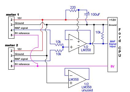

Message The idea has been around for a while but it's good to see someone made an easy install kit for the Z. Here is a schematic of one if anyone wants to try to DIY. A little web searching will find some better designs.
