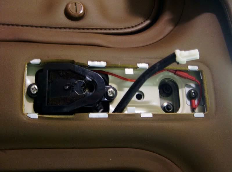

Message This is a sketchy pic presentation but...
Remove the reading light assembly and rear view mirror. Note the nifty notch at the
base of the finisher (not shown in this pic) that covers the 3 bolts that hold the mirror base to the car roof. This
finisher notch will be the exit for the ground and hot wire to your V1.

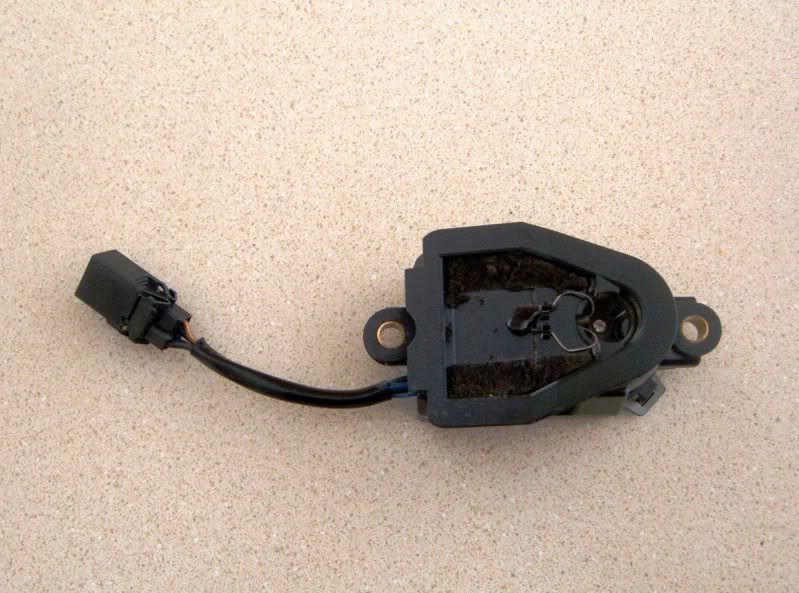

Remove the aspirator from the top of the car and find a switched hot wire that runs to
the aspirator harness.
Carefully cut the sheath around the aspirator harness wires in two and tap into the
switched hot wire
Make your tap wire long enough so it can terminate near the front of the light assembly
opening. Attach a bullet connector at the tap end. Reinstall the aspirator. Complete the wiring to the V1 with two
wires, one with a bullet connector to complete the hot line and the other with a ring
connector to be used as a ground. Have the hot and ground wires (I used the phone line supplied with
the V1) exit to the interior by passing them under the mirror base and through the notch in
the mirror base finisher. Exposing about 1 foot of wire will permit visor or window V1
mounting. This exposed wire can be tucked up under the visor out of sight when you
don't have the V1 in position.
