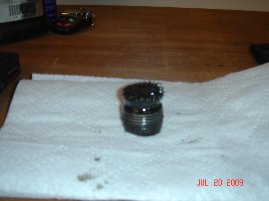

I pulled the trans knowing I needed to replace the pilot bushing and throwout bearing due to whine noise. This seems a little excessive to me. I am thinking to swap the trans with the 74,000 mile spare I have.

How many miles since this plug was pulled last? (n/m)
en5
10:25:33 07/25/09
About 6,000. (n/m)
Boosted1
10:29:08 07/25/09
I'd say yes, quite. I had maybe that much after ~40k. (n/m)
en5
10:39:17 07/25/09
excessively blurry. (n/m)
inf
12:24:41 07/25/09
What kind of fluid were you using? (n/m)
Summeronthechain (MN)
12:28:41 07/25/09
Whatever is called out in the Service Manual.
Boosted1
12:41:11 07/25/09
It should be 75W-90 GL4 and not 75W-90 GL5. (n/m)
