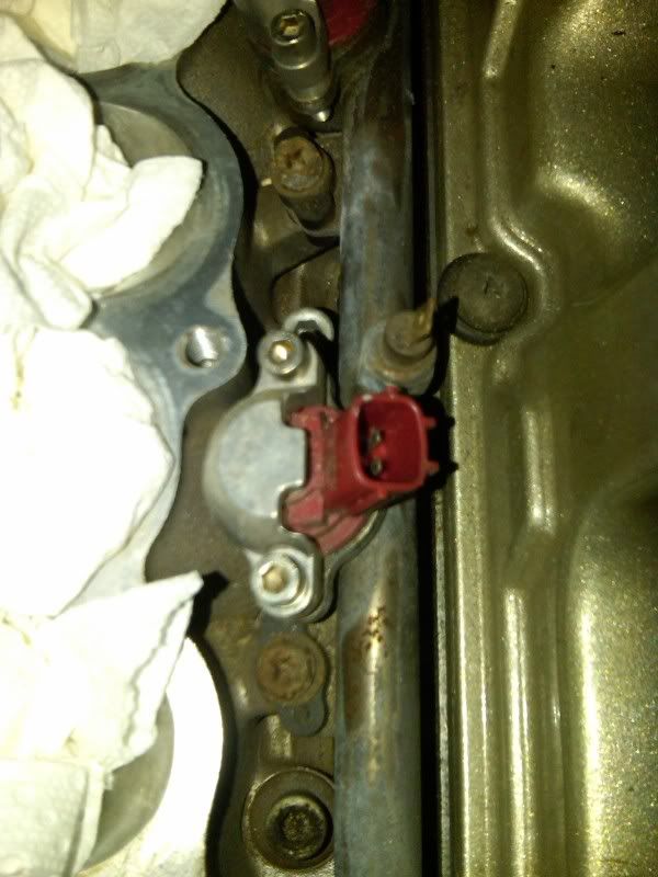

While waiting on new parts going to be doing a lot of cleaning!
injectors
Nis300owner
02:16:12 07/06/09
370,555,740, Low Miles, Probably one off (n/m)

2nd. Let's confirm if this is an actual Nismo new style

Looks like the 740's to me. (n/m)

Those are new style. (n/m)

Do you have one of the side of the injector? (n/m)

I think they are 740cc Deatschwerks NOT Nismo injectors.
