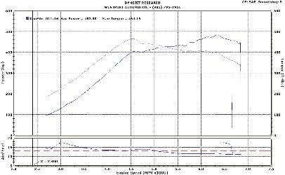

Message OK first off thanks to those that replied to my various posts regarding balancing actuators and trouble shooting my poor dyno numbers.
It turns out that poorly balanced actuators was the main problem. I am now convinced that the ridiculous amount of money that I spent on my car is justifiable!
The HP line isn't as smooth as I'd like it to be around the 4500 - 6000 range but it's 100HP more than my last run! I only did 3 pulls. With a little more time and some adjustments with the Boost Controller I'm sure I could get it smoothed out a bit.
Hopefully the pic looks OK. I don't post many. I've added the link in case you want a closer look.
The verdict was 483 WHP and 464 Tq @ about 19psi on 94 octane. My base boost is now around 17.5 and I ran ~450 whp on the springs. I may bring the base boost down a bit closer to the 15 psi range but for now I'm done messing around and plan to clock a few miles on the new set-up.
Z1 675's with AMS manni's, 3" DP's and TP's
