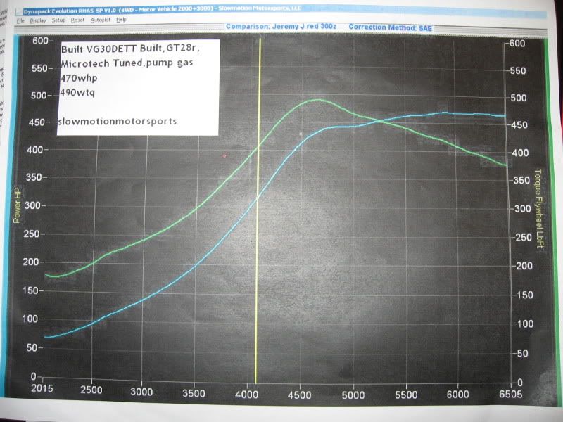

Obviously with the Microtech standalone I had to have the car tuned professionally, so today after a long wait I met up with Corey Parish at SlowMotion Motorsports in Columbus to get the car tuned. After changing spark plugs and gapping to .28 the 8 hour day was underway :). For those that don't know my current mods on the car are listed below:

Finally after spending all day first of all learning how to tune Microtech, and carefully shaking the car down I was pretty pleased with the results considering we were only running 93 Octane and 20psi
490 Torque
470 Wheel Horsepower
Sorry that its a picture of a printout, thats the only way I knew to get it online, results will probably end up on their website at some point.
All I can say is this thing pulls hard and fast to redline in every gear.
