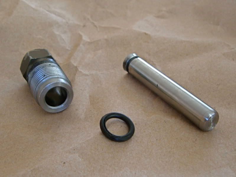

Message repaired a leaking pump plunger which is the part indicated by the blue arrow here:
After removing the parts that connect the handle to the plunger, disassembling the
plunger on this jack produced these parts:
On my jack the o-ring is all that seals the plunger and it nests in a groove in the bore
of the threaded part shown. I readily sourced a new o-ring and by inserting the rod
into the bore up to the groove (so that the ring could not go down the bore past the
groove) I was able to install the new o-ring in less than a minute.
You may need a deep socket and a breaker bar (or impact wrench) to get the plunger
apart. But other than that, a repair like this for a leaking plunger can be done for
about $.50 plus the cost of more hydraulic jack oil.
