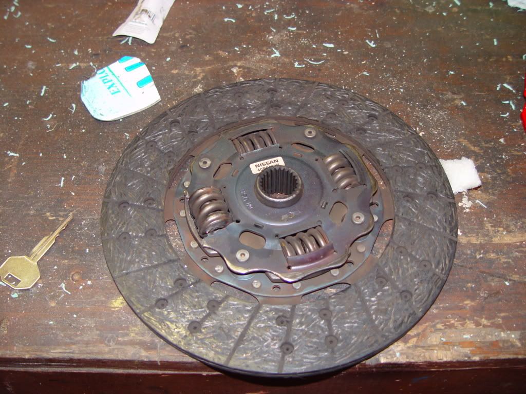

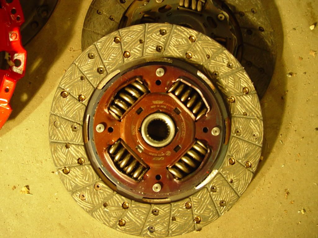

Upon removing the transmission this is what I seen:
Apparently the metal holding the spring in had broken and ejected the spring.

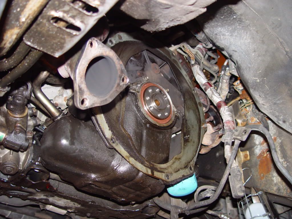

Replaced the rear main seal, TOB, and Pilot bushing.

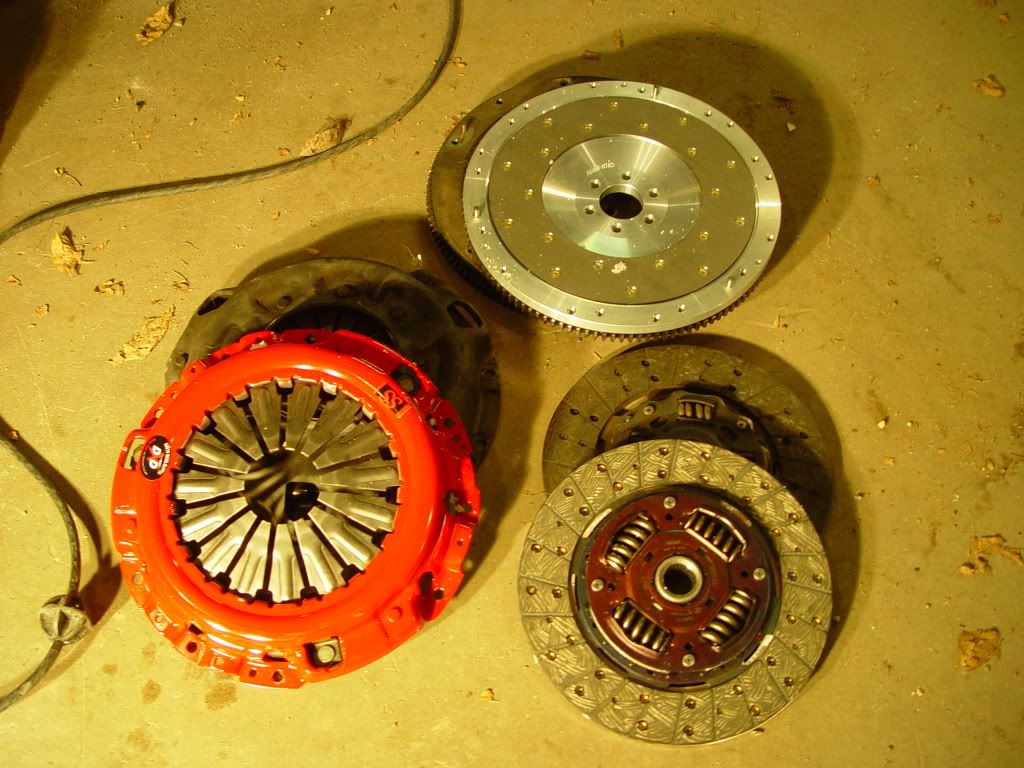

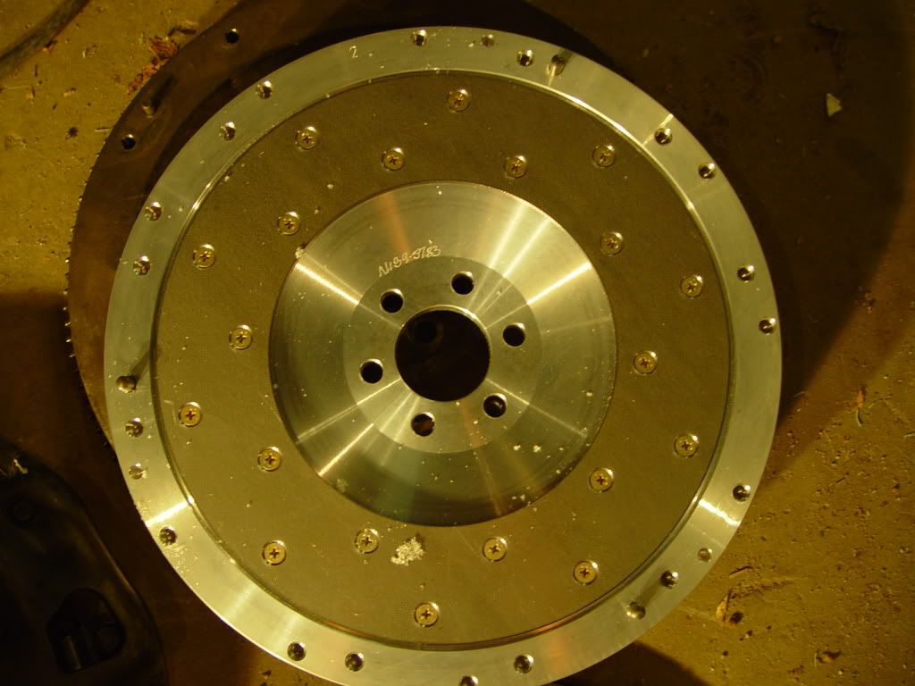

Ordered up a new Southbend OFE-X clutch and flywheel from Joe:
After getting sent a flywheel from a z31 the first time, and then a flywheel that had been machined improperly the second time, I finally got all my parts and the install done.

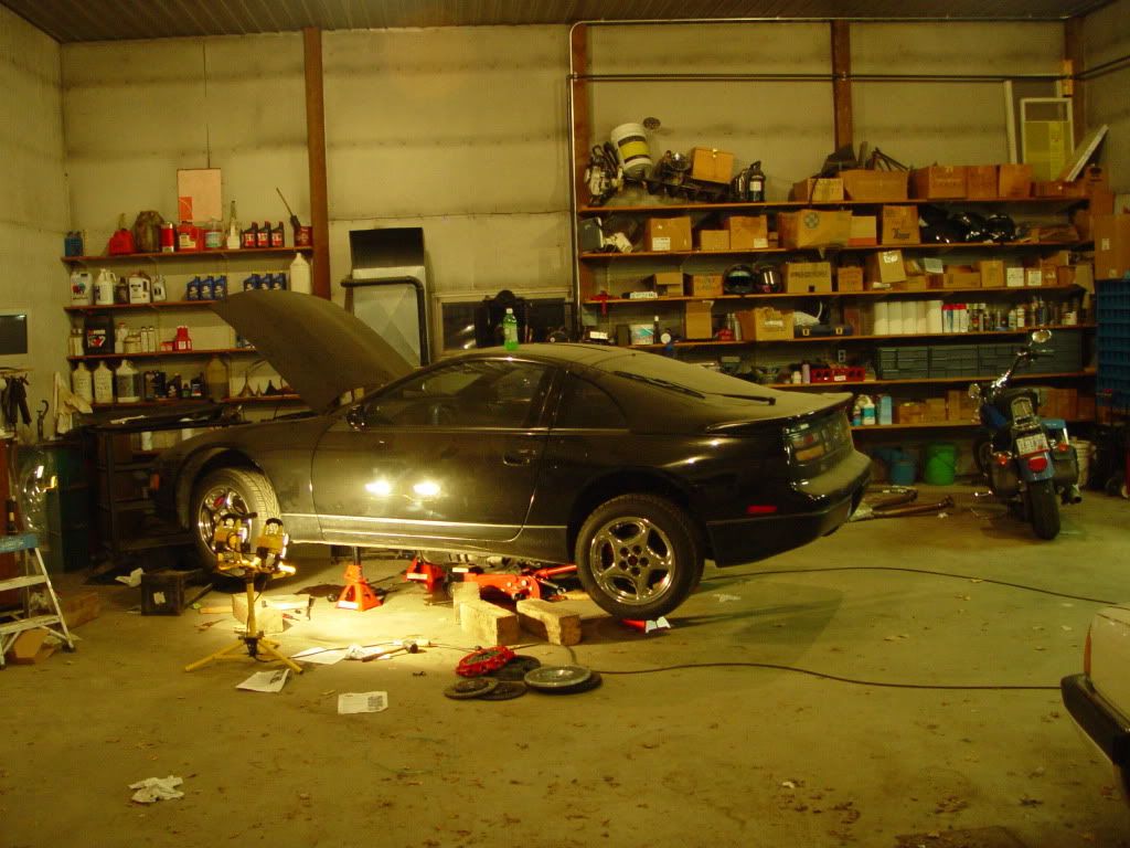

But for about 4 months, this is all I had to stare at:
