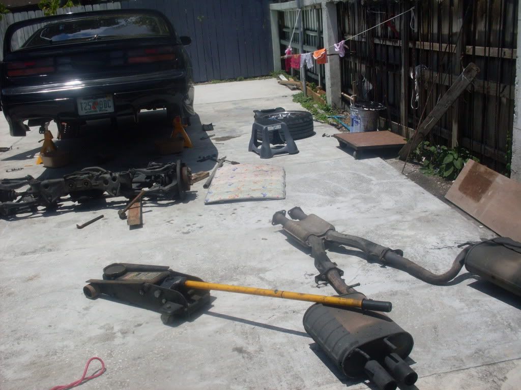

Message HERE IT IS A 1990 300ZX N/A SUBFRAME WORK
FISRT JACK UP YOUR Z
YOU TAKE OUT YOUR EXHAUST SYSTEM

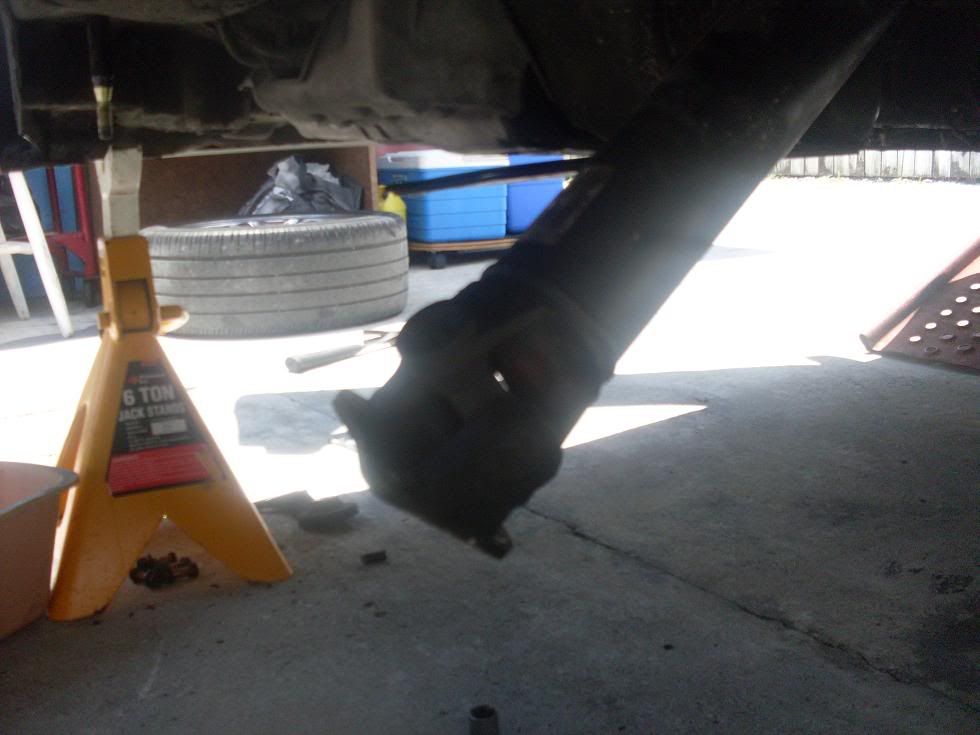

YOU TAKE YOUR DRIVESHAFT AND UNBOLT IT

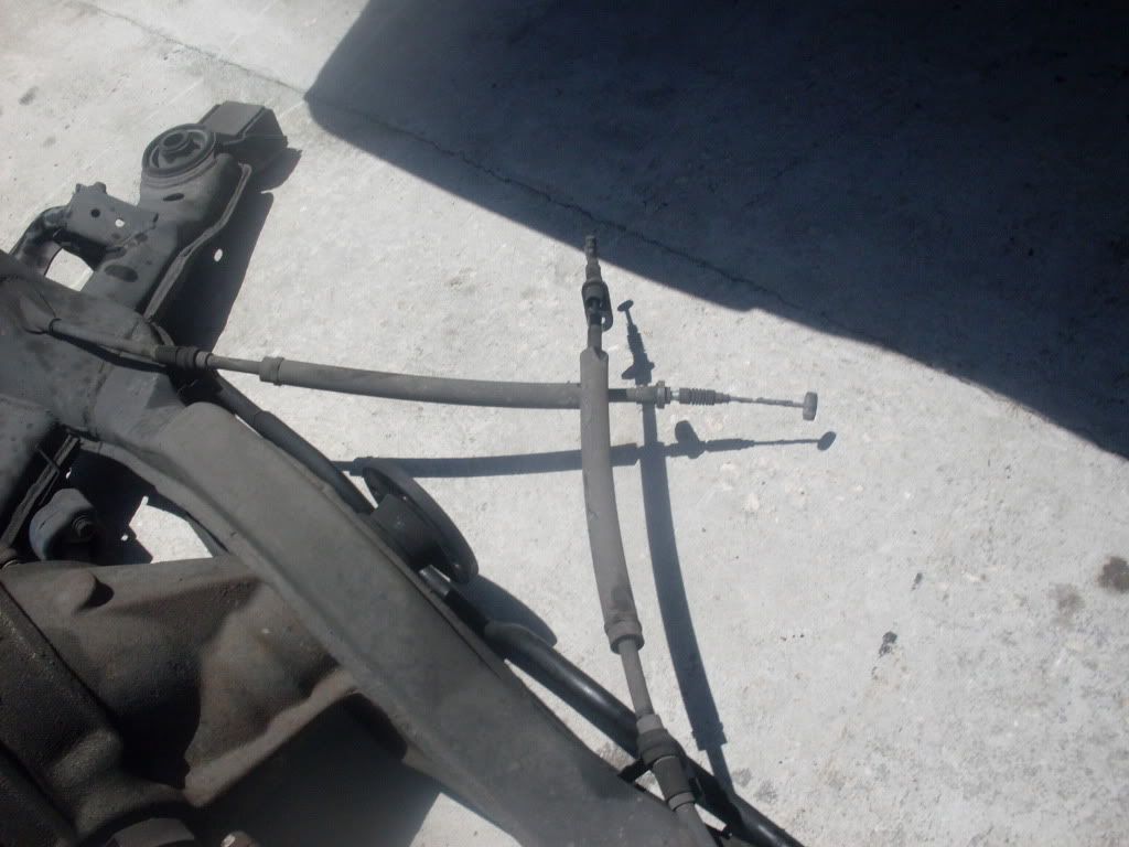

OSSE YOUR E-BRAKE CABLE AND BRACKETS

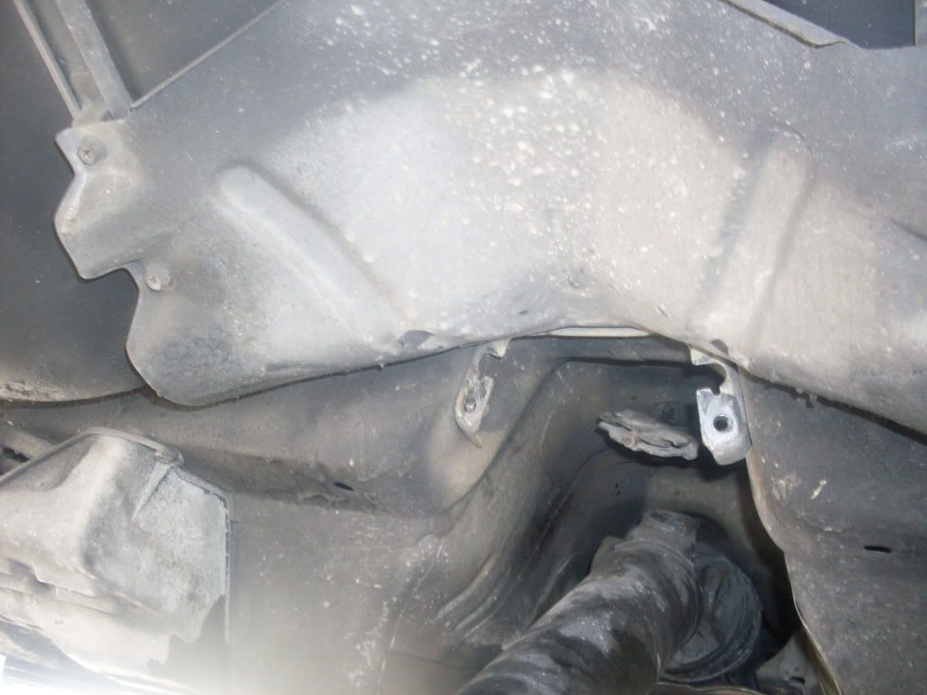

YOUR ABS PLUG

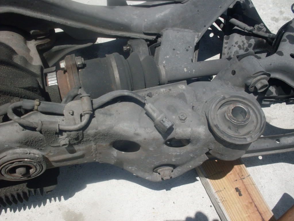

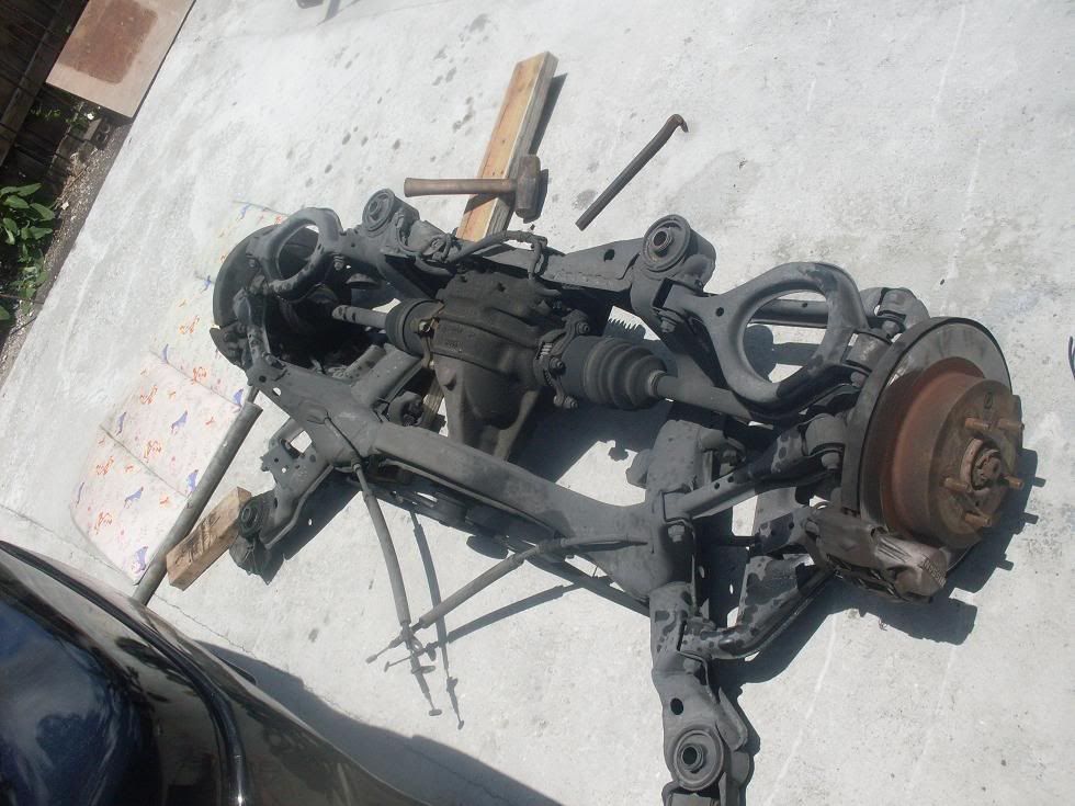

AND BOOM THERE YOU HAVE IT OF COURSE THE FOUR MAIN BOLT THAT HOLD THE SUBFRAME

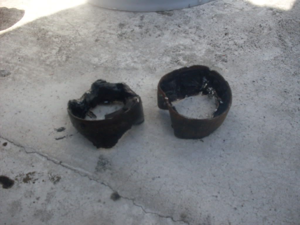

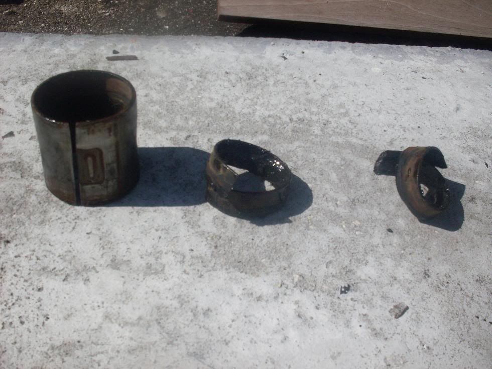

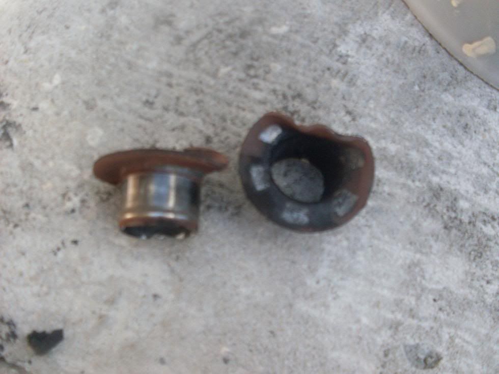

I HAD TO TAKE THIS METAL SHELLS TO MAKE THE ENERGY SUSPENSION BUSHINGS IN EACH SIDE
DIFF FRONT BUSHING I HAD TO TAKE THE METAL OUT SO THE BUSHING CAN FIT
AND THE DIFF REAR BUSHING I HAD TO TAKE THE METAL SHELL OUT TO MAKE TOO
