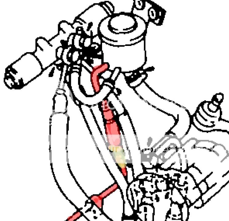

Subject are you talking about this one?
Posted by Ahmed (Chicago) on April 07, 2009 at 10:27 AM
  This message has been viewed 220 times.
In Reply To Power Steering posted by BradleyTT(OK) on April 07, 2009 at 09:22 AM
Message this is the one i just replaced and posted about a few days ago...there is a metal crimp where that yellow spot is...the crimp attaches it to the metal hardline (still don't know why Nissan did this)...you will need to CAREFULLY dremel the crimp off so you don't cut through the hardline underneath, replace the rubber hose (i replaced it with silicone hose from IPP), and use a regular clamp on it...if you look on Kyle's website, it explains it over there also
