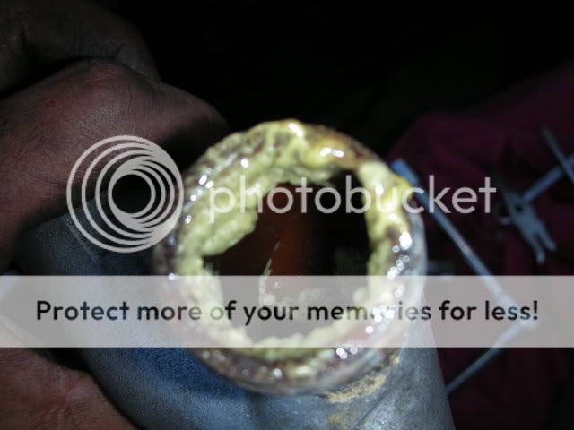

Thinking thats from oil/coolent mix maybe???

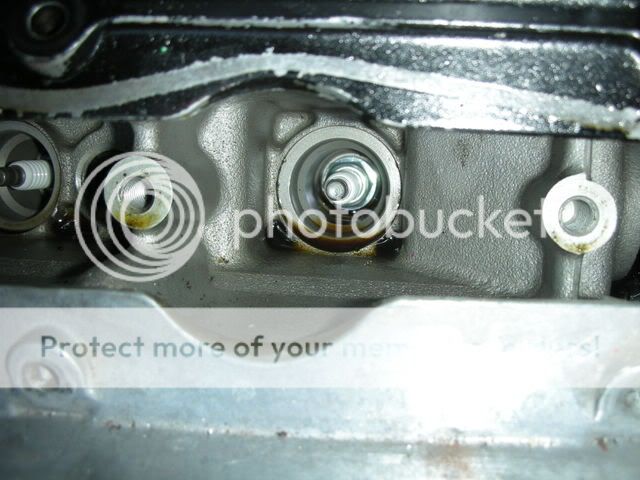

Dont know how that got there. Valve cover seals looked fine and i saw no drain/streak marks

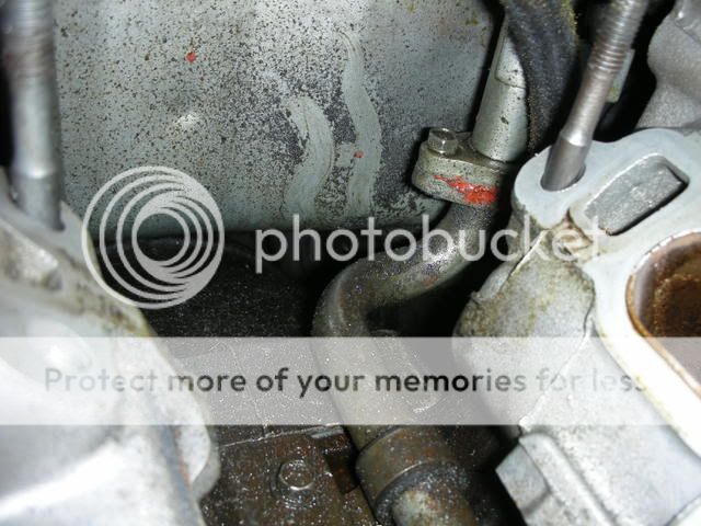

Thats what shredded head gasket looks on your fire wall

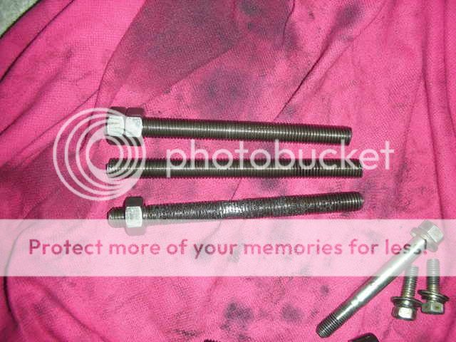

Here are the trouble makers. thought there was only 1 but turns out we put in 3. the one that caused the gasket to go wasnt even all the way tightened to the head i dont think. from what it seems like the nut got super stuck on the bolt before it even reached the head somehow and we thought it was good and sung when it wasnt. Explains why it went so easy.
you can see all the head gasket in the threads
