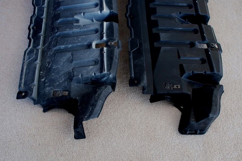

The difference is more obvious in the pic below.
The lowest most portion (the peninsular part) of the TT version (left) is
reduced so as to provide clearance for the stock IC air guides. Also, it is at more of a 90
degree angle relative to the body of the guard compared to the NA version.
For TT applications with SMIC the NA version is not interchangeable with
the TT guard, at least not without modification for IC air guide clearance.
