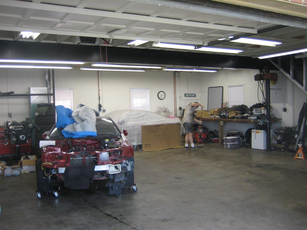

Day 1.
07/2003
cleaning the wreckage

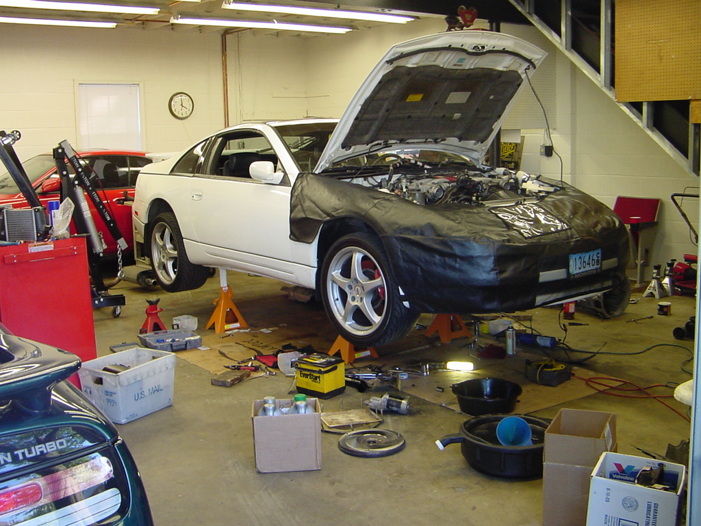

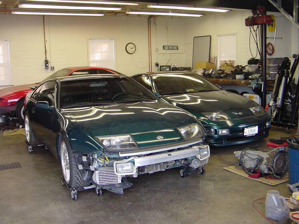

11/2003
yugo cameo, and lets push it out of the garage (again)

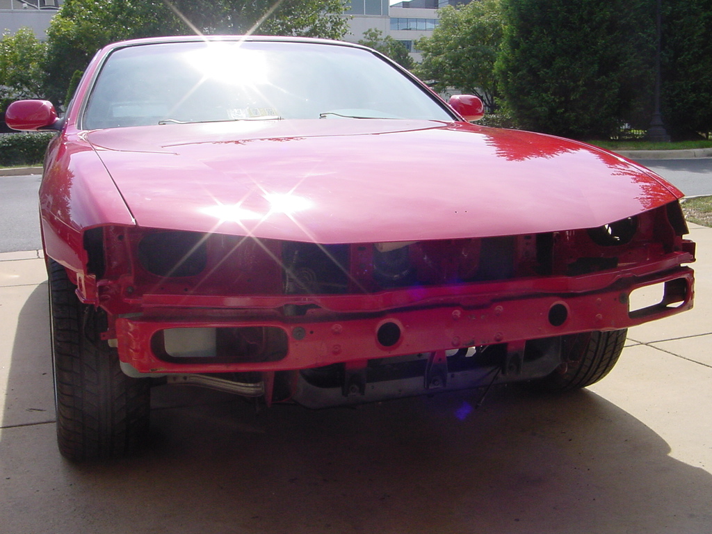

04/2204
glenn worked his magic

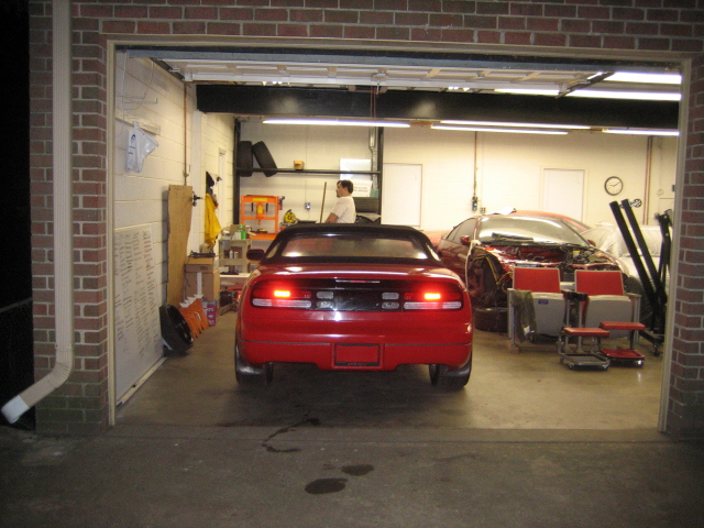

09/2004
boxed in behind other cars in the garage - just a sample...

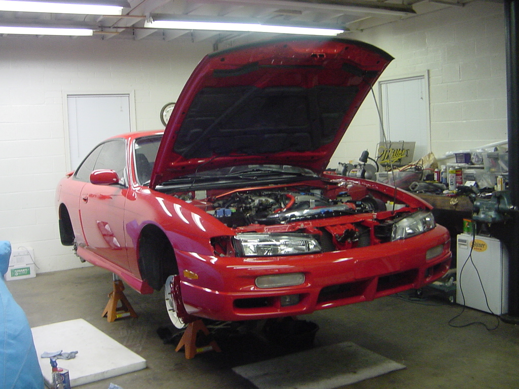

06/2008
The rest of the summer passed w. the 240 perched, ready for action and aside form an evening or 2 not much happened around it. I did start getting refocused on getting the remaining parts that I needed - at some point over the years I had decided that a 5 speed conversion would have to happen so I went after the parts I would need for it. I nearly bought an entire parts car donor out of Texas thanks thanks to JohnY & Kong but the seller flaked out and I just started to piece things together.

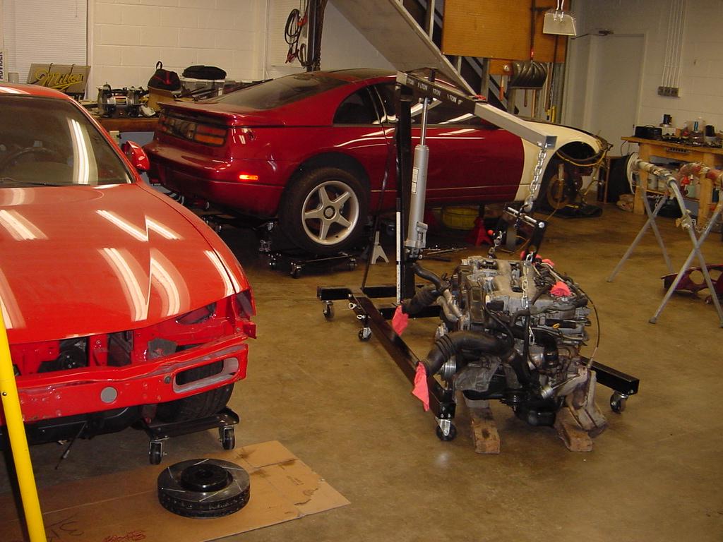

11/2008

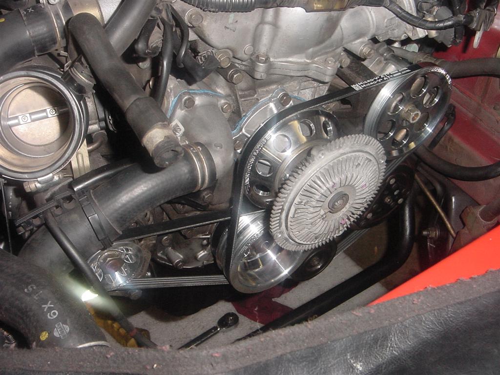

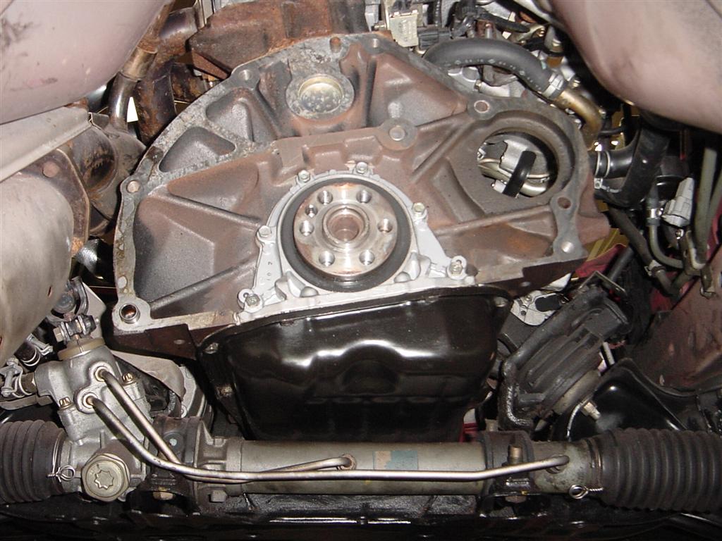

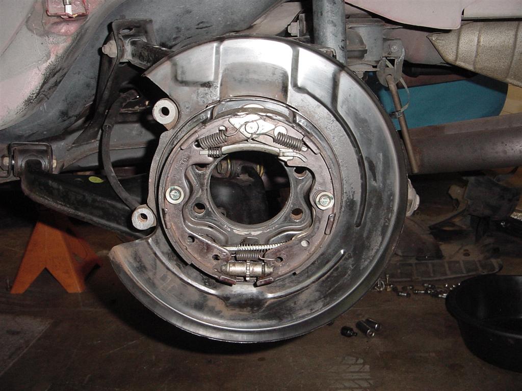

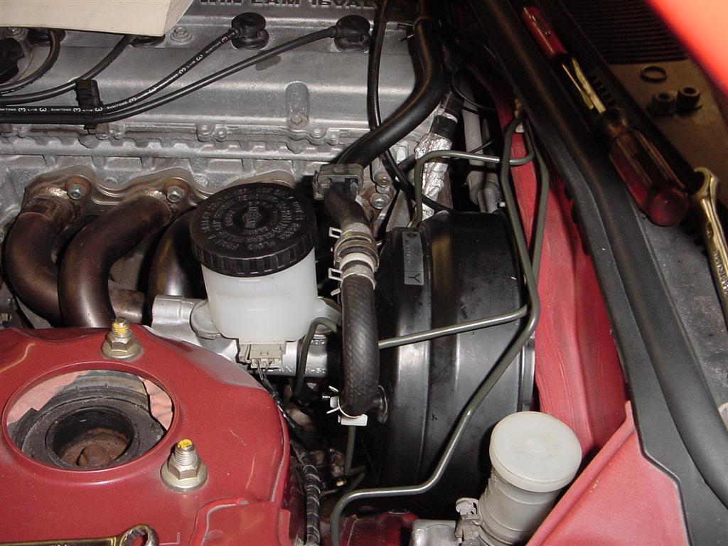

auto trans out, Z32 BMC conversion, Z32 rear ebrake & LSD diff conversion

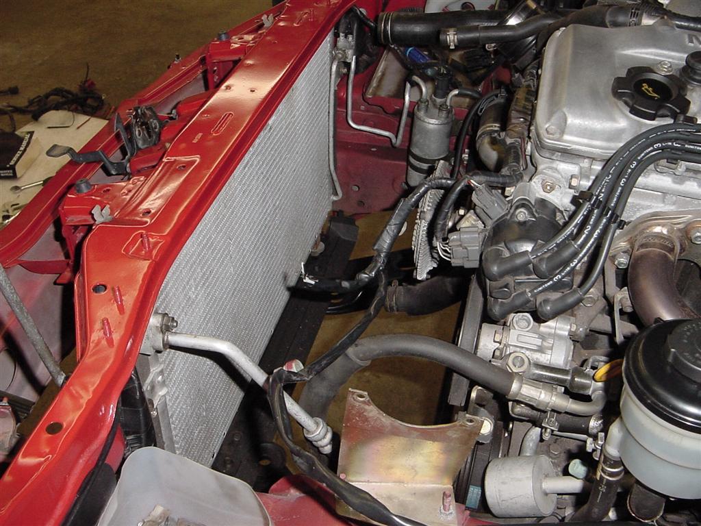

AC system reassembled, pulleys installed,

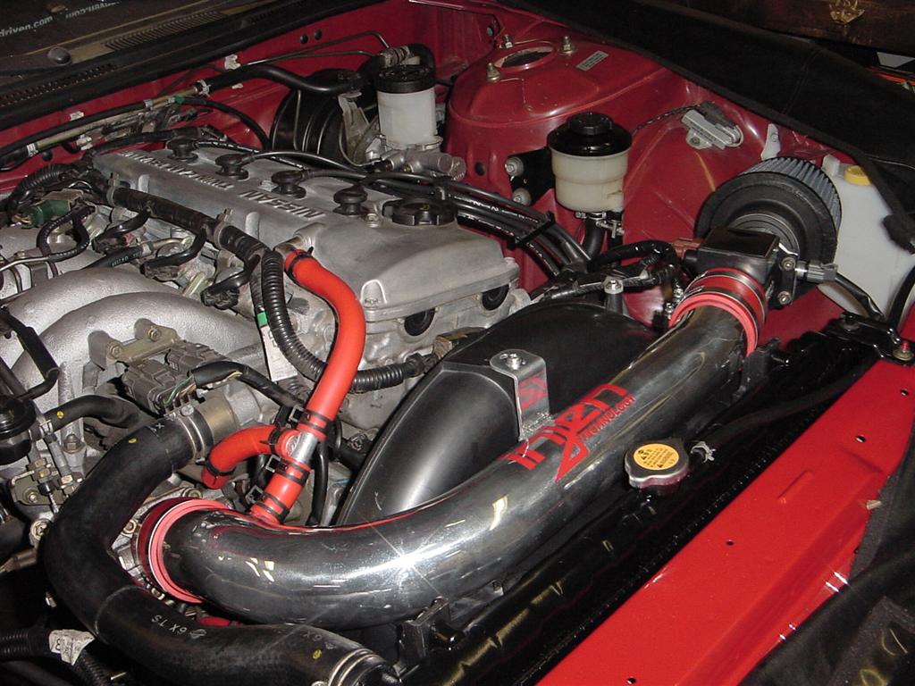

Suspension, intake, Evo brakes

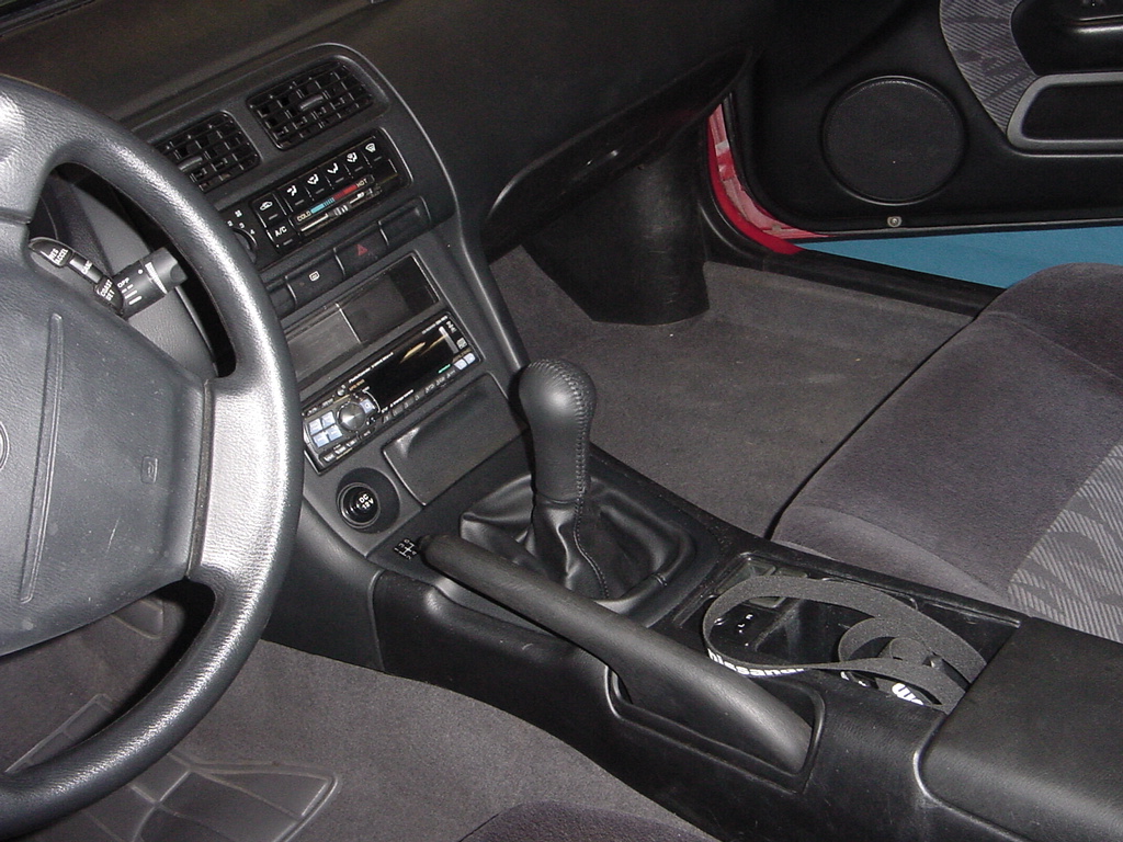

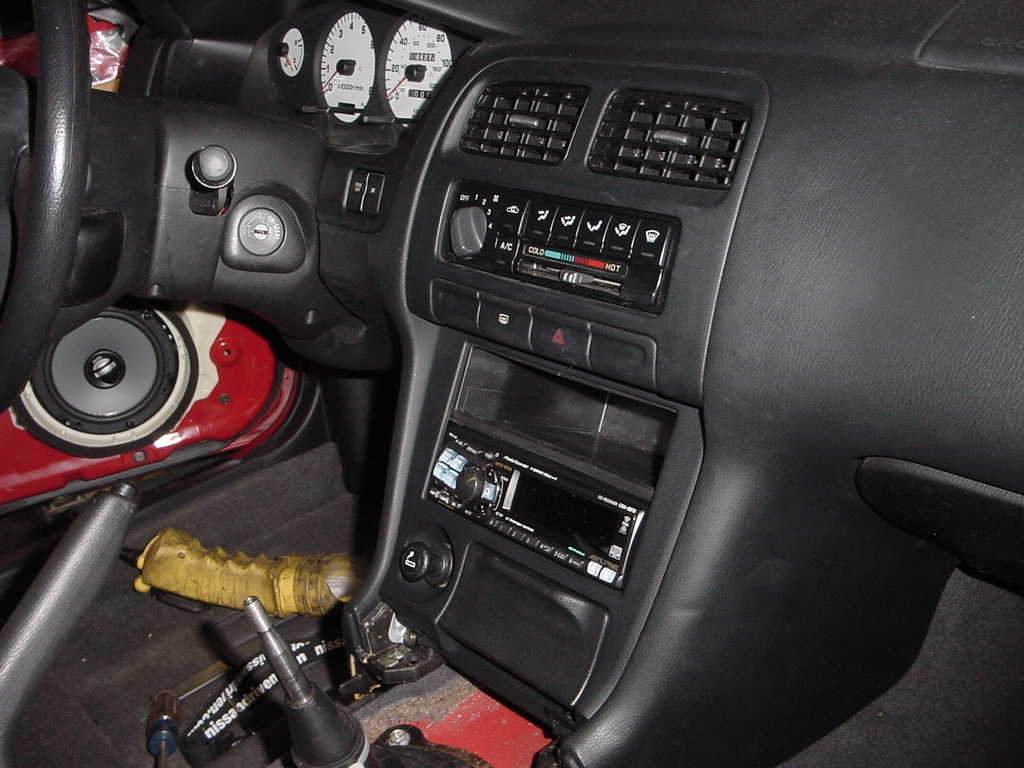

5 speed in, radio & interior coming together

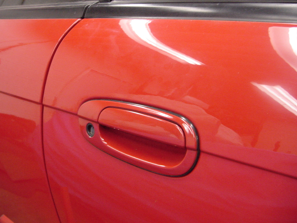

OMG door handles for the 1st time in half a decade

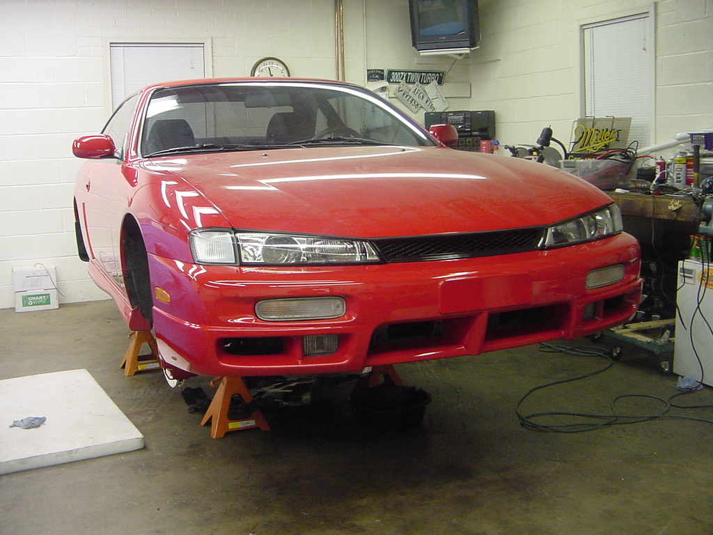

getting there
damn
The gas in the tank was at least 6 years old.
Started up on the first try after they system primed.
after 10 min the idle was rock smooth @ 750rpms
No codes, fully OBD2 compliant transconversion as well.
