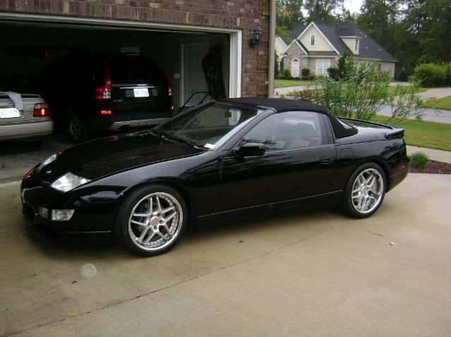

Message The Heartbreak Dyno didn't hurt me too much. Dyno and road tuned by Ash Powers, Boost set at 18 psi with water injection running on 93 octane fuel. A/F ratio held steady between 11 and 11.5:1 on the wideband.
I am very satisfied for now and plan to enjoy the car! Very torquey and fun to drive. I was thinking of adding MS manifolds with this setup at some point in time. What would the addition do for my torque curve?
