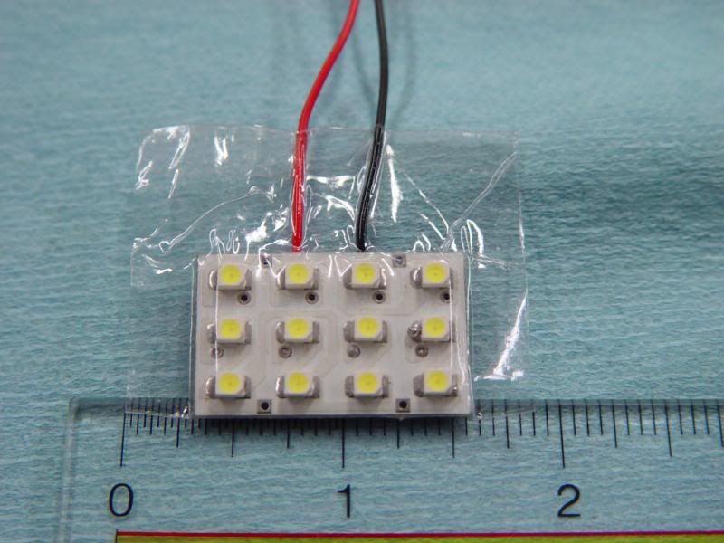

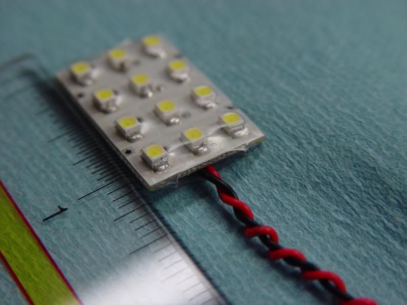

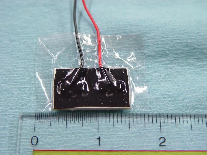

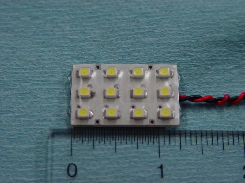

It looks like i found the perfect way to cover the raw circuit board from the road elements.

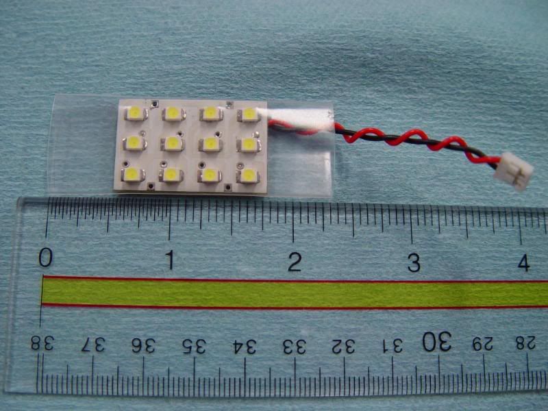

Verison:1 (Photo Laminate paper)

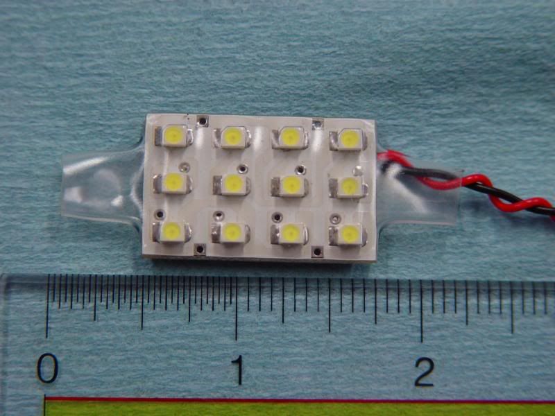

Version:2 (1/2" Clear Heat Shrink Tube) cut oversize at the ends resulting on trimming.

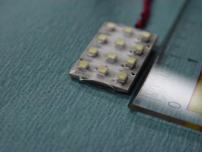

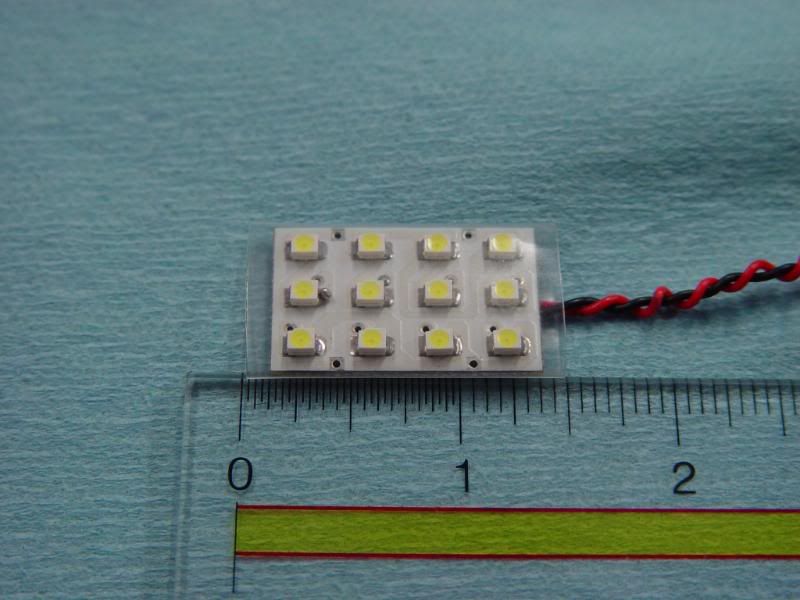

Version: 3 (Best results) NO trimming required. Only thing left to do is apply clear silicone along the edges.

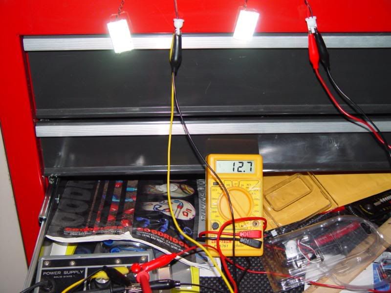

Tested at 12.7 volts for 8hrs and able to hold in hands.
