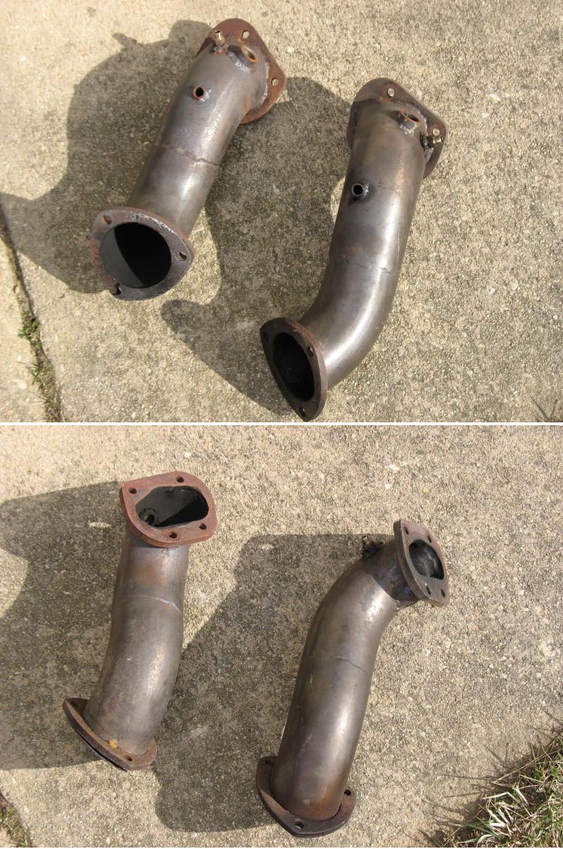

Message Stock JDM (and euro) Nissan DOWN pipes:

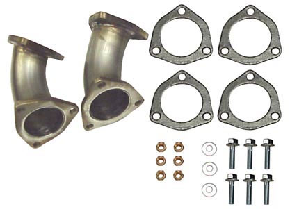

Stillen QUARTER Pipes - used to adapt JDM downpipes (typically the 5 bolt down pipes that came w. the HKS 2530 kit) to USDM TT cats/test pipes.

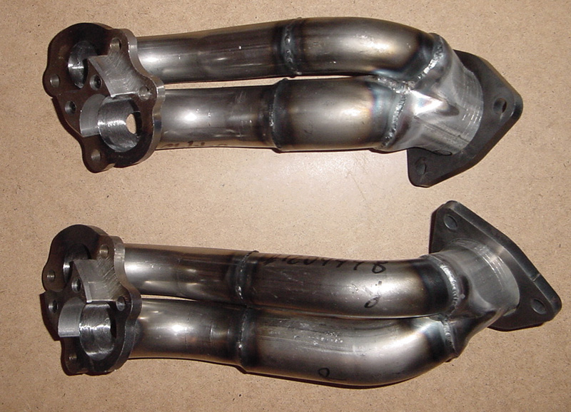

USDM SpecialtyZ split down pipes:

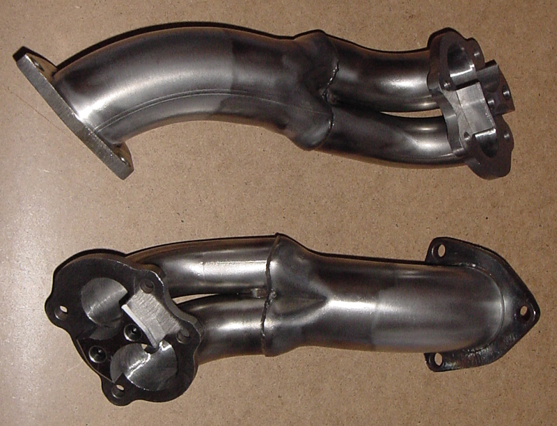

USDM SpecialtyZ super split down pipes:
USSM SpecialtyZ super split/expansion 3" down pipes

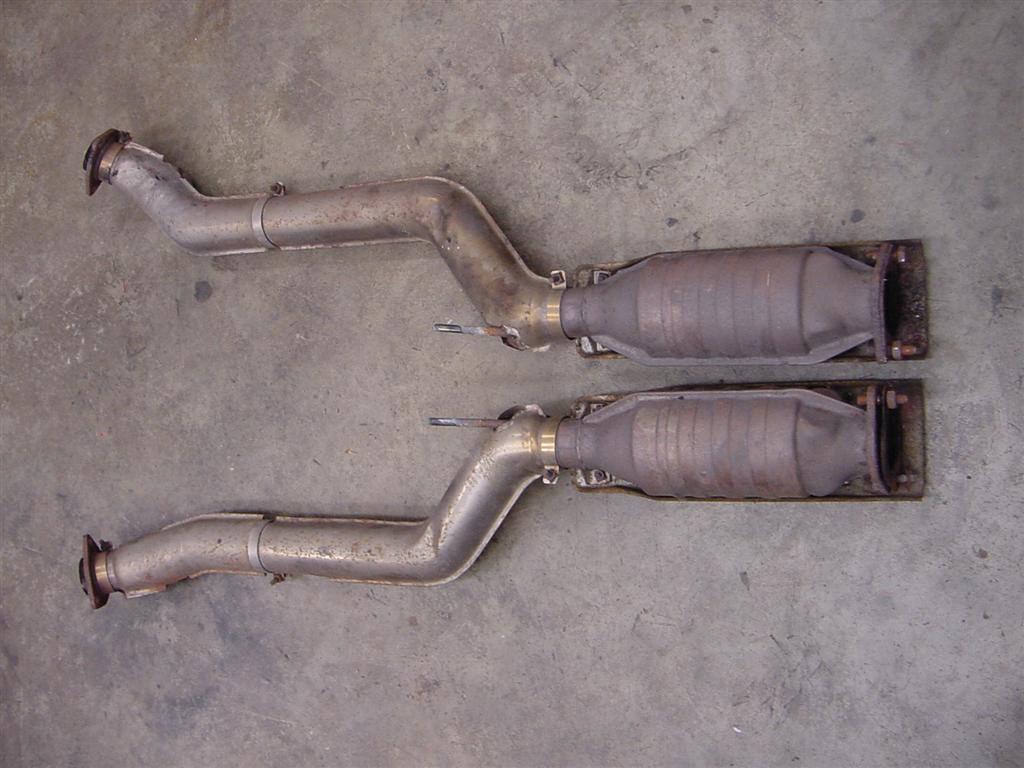

USDM TwinTurbo Cats - note that the flanges face forward

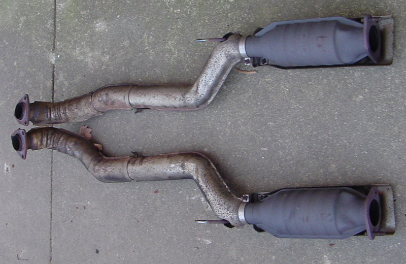

USDM NA (and JDM/Euro TT cats) - note that the flanges bend up
