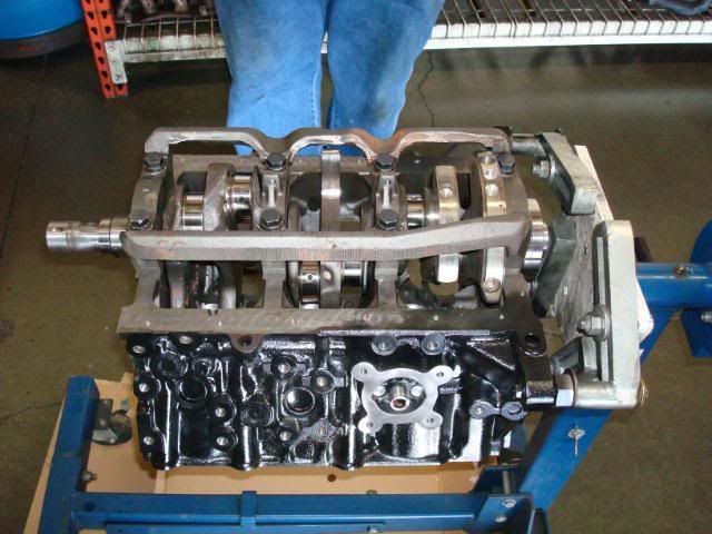

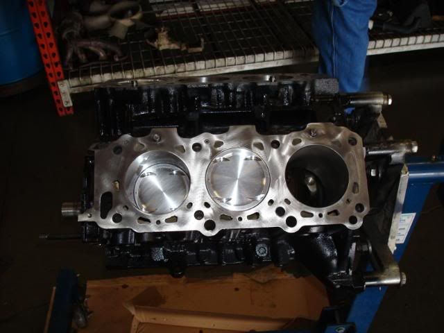

Some JE pistons @ 20 over

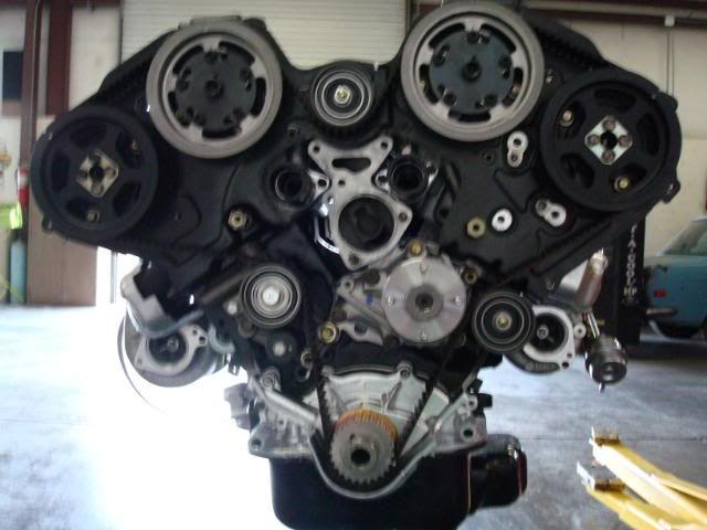

The entire rotating assembly has been race ballanced and chryo-dipped at 300Bellow.com

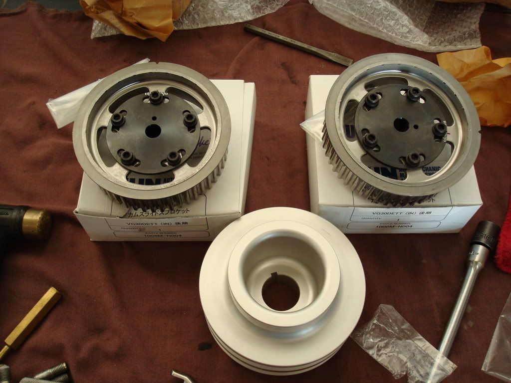

Jun adjustable intake cam gears and a UD pulley

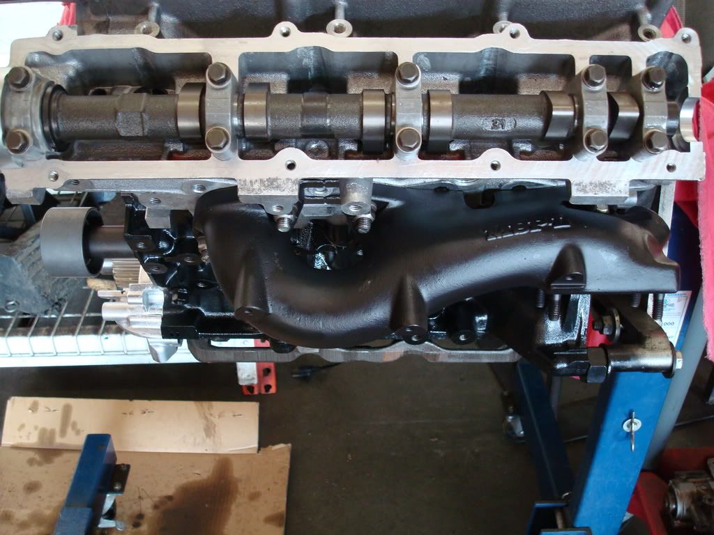

Jwt 400+ cams with some MS manifolds on Stillen race heads

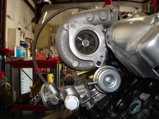

JWT530BB

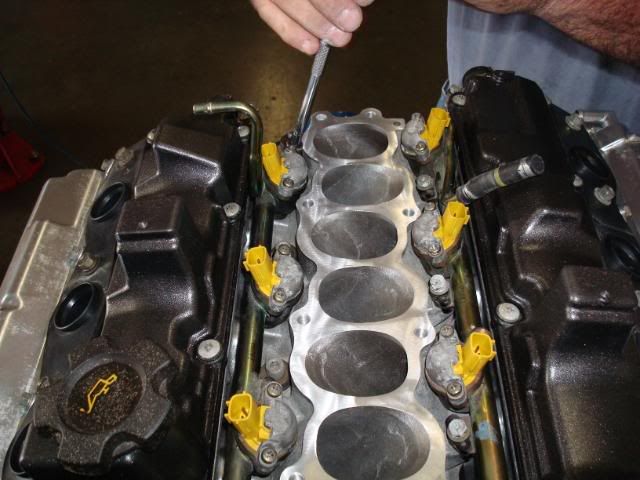

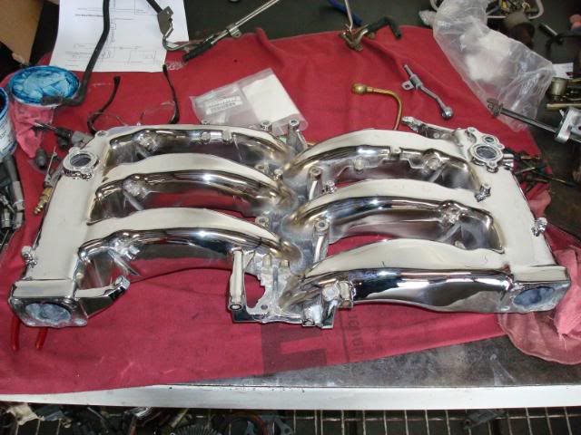

Nismo 555 injectors w/95+ fuel rails and 95+ lower intake

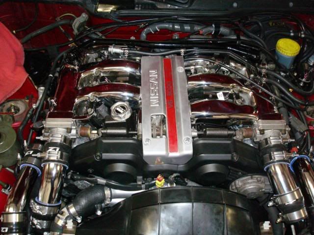

I always enjoy this stage of engine pics, don't know why though. I don't entend to play with the exhaust timing so we'll see what happens.

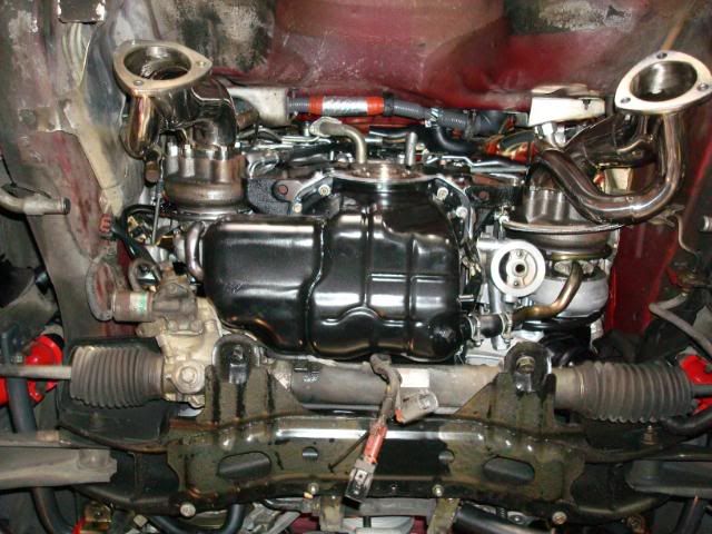

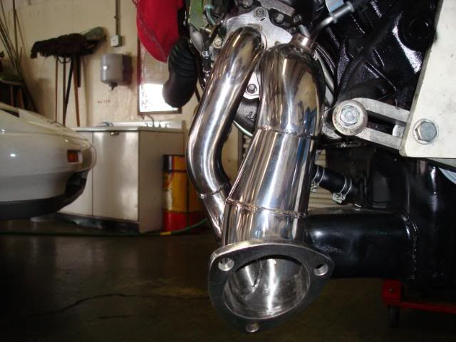

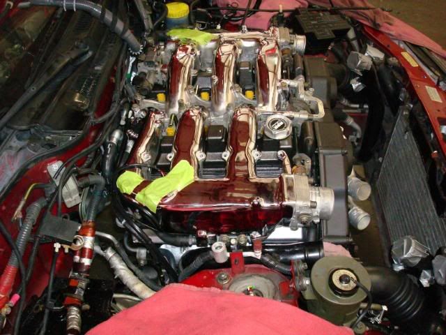

Please take note on these next few pics as i've never seen a TB bypass done this cleanly or sexy before. This is just one example of Marty's attention to detail that confirms I have the right guy for the job. He used additional water piping from a J30 to minimalize the use of rubber hosing to provide this "uber" clean look.

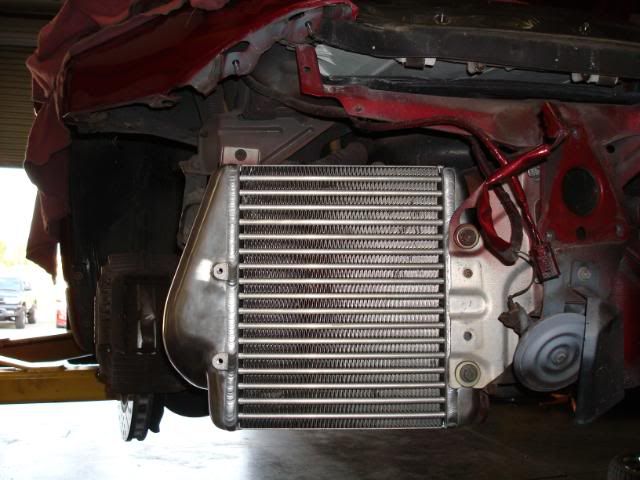

HKS SMICs, they were on sale at the time of purchace

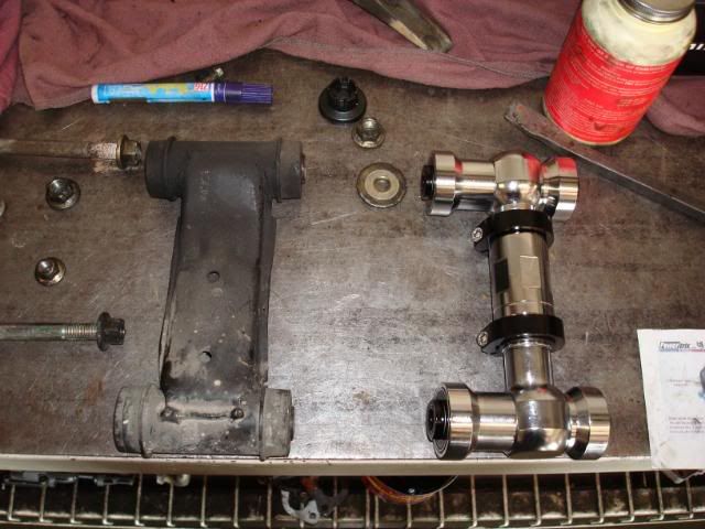

I went with the basics on this.

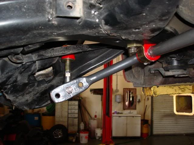

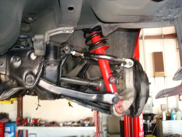

KYB Adjustables. I'm keeping my NA rear sub-frame and dif, we'll see how it holds up.

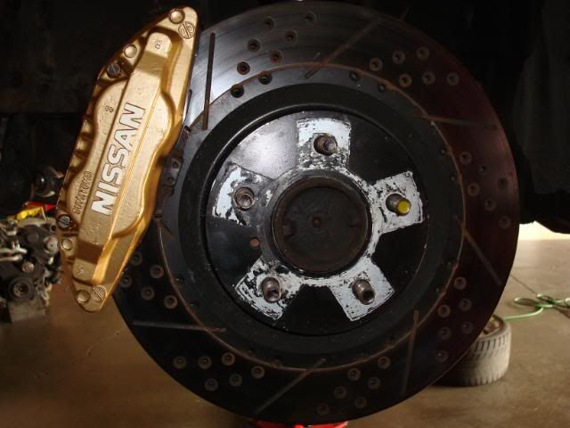

Hand painted in "Ghetto Gold" for a little contrast:-) w/ 350Z track rotors

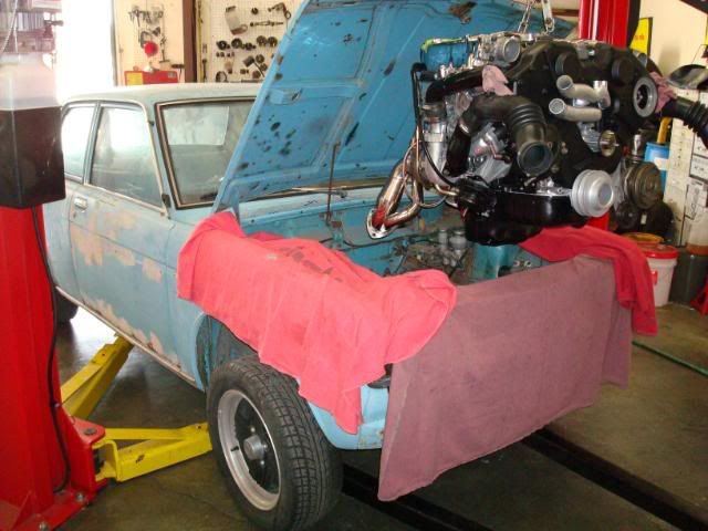

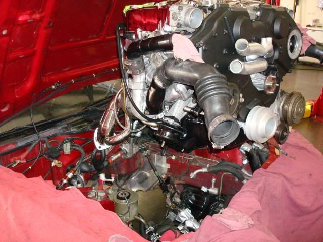

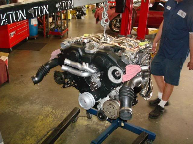

Ready to be shoe-horned in its new home.
The guys were playing around while I was out. It would be a fun 510 though, just melting tires!
But seriously.
It actually does fit!!

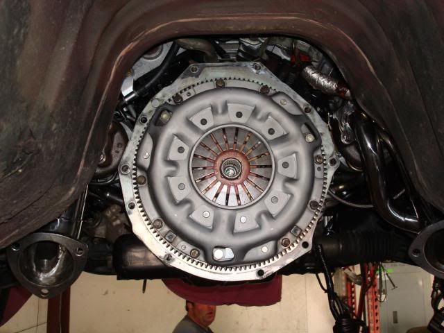

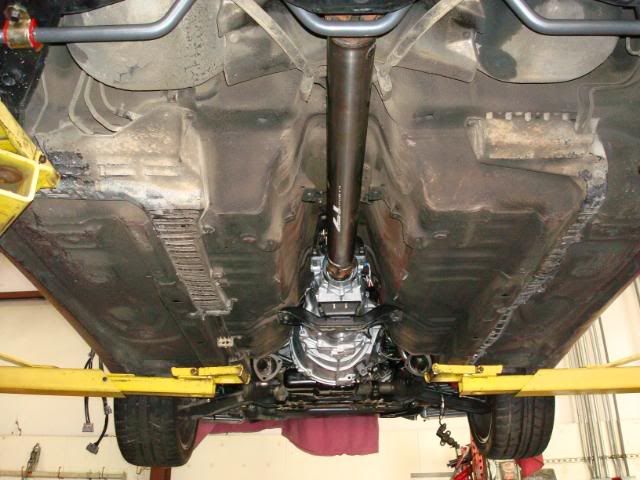

JWT Hvy Duty clutch and light weight fly wheel.

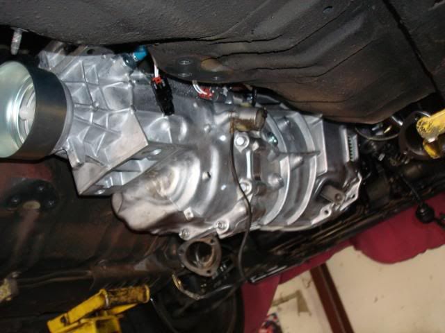

99+ 5spd manual Tranny, we'll see if that grinding goes away from 3rd to 4th.
Z1 one-piece DS, was already part of my stage 3 car.

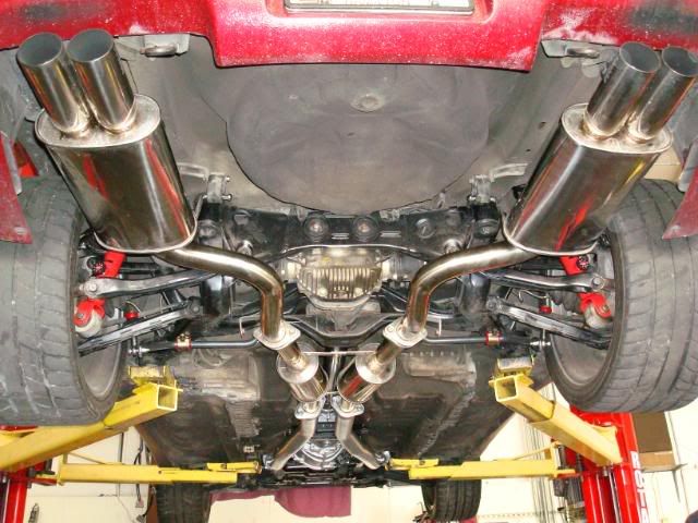

Outta $$$$ right now so I'm staying with my Megan exhaust and was exited to still have my resinaters as well.

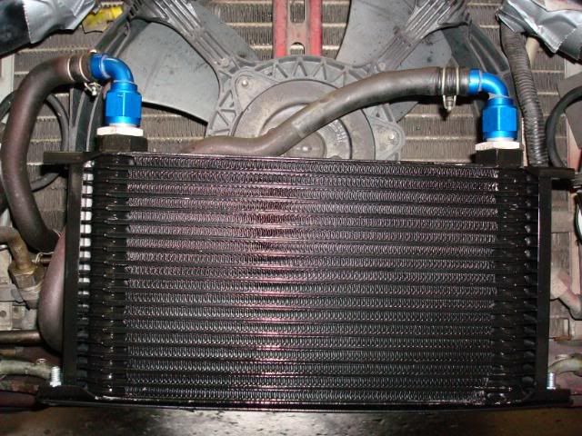

Stillen oil cooler.

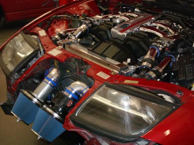

The bay, Z1 hard pipes, T-bolt clamps, Hose techniques silicon hosing, and Koyo radiator. This was mocked up with a stock TB cover that I will be replacing with a Carbon Powertrix cover to work with my Carbine strut tower brace.

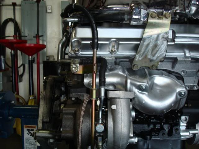

JWT Twin Pops.

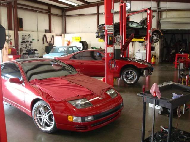

I'll post pics of the finnished project soon, can't wait much longer. This pic is a tipical site at Walkers import auto repair, now hosting 3 Twin Turbos. The black one in the back getting an alternater job dynoed at 657rwhp. Chattanooga's starting to represent, be lookin for us.
