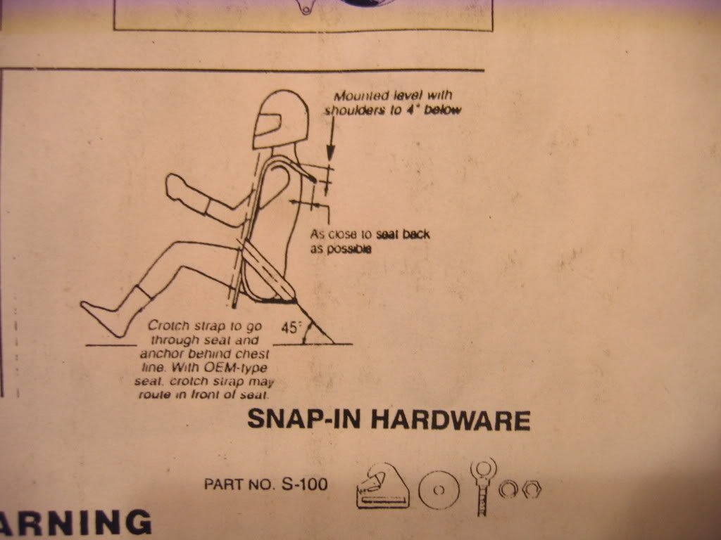

TwinTurbo.NET: Nissan 300ZX forum - per instructions included with autopower 5 pt harness

Will the 5 point harness work with stock seats?
posted by ZonaZ
on June 18, 2008 at 02:27 PM
"with OEM type seats, the crotch strap may route in front of the seat"
ZonaZ
14:27:37 06/18/08
think about it....if it has to grip you btw the legs, a new

You can slit the OEM seat without much issue. I have

ok, thx. Can't afford new seats right now so that is what I
ZonaZ
15:08:28 06/18/08
if you have clean, black leather seats, i am sure you can

per instructions included with autopower 5 pt harness -

I drilled through the floorboard next to the rear seat
Guapo
16:01:50 06/18/08
how many eye bolts and backing plates did you use?
ZonaZ
16:42:52 06/18/08
6 total. One for each sub belt, then one for each

6 meaning both driver and passenger. Only need 3 per set

for the crotch, mount the eye bolt under seat? halfway? (n/m)
ZonaZ
20:48:26 06/18/08
yep (n/m)
