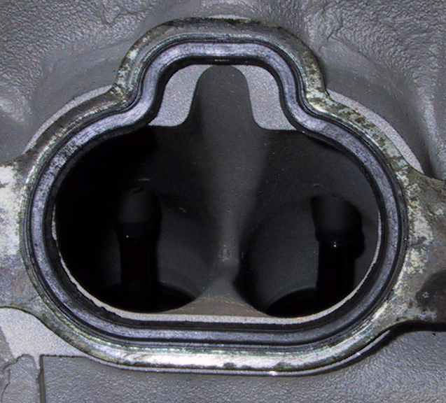

Message This is INCORRECT, 95+ gasket on a 90-94 head:

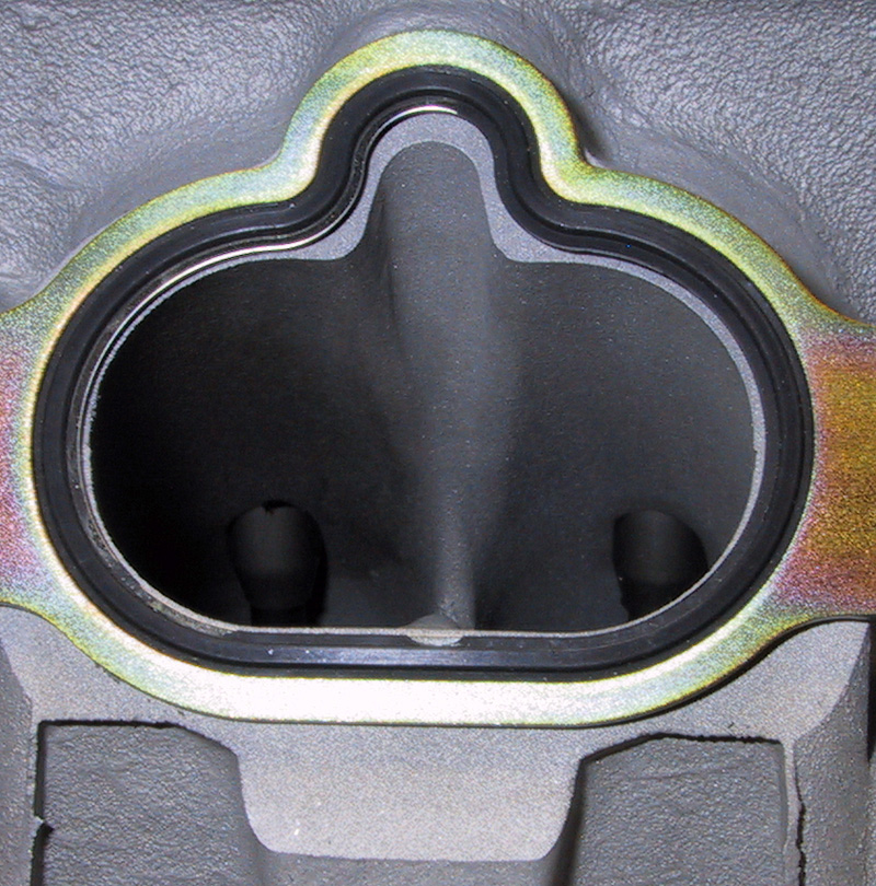

This is CORRECT, 90-93 gasket on matching head:
The material isn't critical is the shape of the ports & gaskets that matters.
This is what happens if you mis-match heads/lower plenums of differnet vintages.
