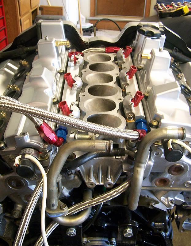

TwinTurbo.NET: Nissan 300ZX forum - Something like this?...
240Z FeO2
on February 22, 2008 at 10:54 AM

Is there a better way to run a parallel fuel setup?
collegeboy
09:15:12 02/22/08
Why do you need to run parallel? (n/m)

Something like this?... -
240Z FeO2
10:54:23 02/22/08
yep (n/m)

True the FPR will see the pressure , but #6 will
AZHeat
11:22:02 02/22/08
I ran parallel on my stock fuel rails. With this set up
AZHeat
11:08:37 02/22/08
negligible imho

I run no damper on mine with 850cc and aeromotive FPR.
The Devils Z
05:30:12 02/23/08
Re: I run no damper on mine with 850cc and aeromotive FPR.
lonloud
07:32:18 02/23/08
Mike is correct in that the injectors do cause pulsations
aliaZ
08:44:15 02/23/08
I believe either way should be fine.. MY THOUGHTS..
Kong ZTT GT28RS MD
19:21:46 02/23/08
I have one fuel pressure gauge and two led lights / switches
The Devils Z
06:38:27 02/24/08
My two pumps run into one #8 AN line and split
AZHeat
11:13:37 02/24/08
I run no dampner on my 850's as well..
Kong ZTT GT28RS MD
19:04:07 02/23/08
well...here's my thoughts
aliaZ
19:40:08 02/23/08
you may be right ...but it's important to note that the
The Devils Z
06:44:11 02/24/08
bigger injectors = bigger pulsations
aliaZ
10:15:44 02/24/08
I have absolutely no idling.. boosting etc issues..
Kong ZTT GT28RS MD
20:14:47 02/24/08
It's probably waterhammer...
CaliguyPurdue (redesigning)
19:50:43 02/22/08
It wont fit with a sleeve. I have over 10k miles on my setup
whitepearlz
12:51:46 02/22/08
running a parallel fuel setup allowed Ash to better
The Devils Z
12:53:02 02/22/08
pics here
The Devils Z
16:33:17 02/22/08
I ran them to the back of the engine on top of the fuel rail
Magnum
14:42:43 02/22/08
