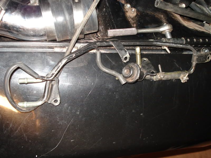

TwinTurbo.NET: Nissan 300ZX forum - The pic shows oem fuel line that I'm going to

its not the hoses that leak....its the clamps
posted by gt300zxtt
on January 29, 2008 at 01:13 PM
go ahead and assume is original. I would recommend replacing that and NOT using worm gear camps as they tend to eat into the hose with time. Changing the fuel line clamp bolts with allen head style is a better option.

while your there, check all your fuel lines for leaks...>
BOOZT_JUNKIE
10:30:39 01/29/08
Check for leaks? Just replace the hose with
EricTTZ
10:56:56 01/29/08
gt300zxtt
13:13:03 01/29/08

Fuel pipes on top of plenum: Yes, some people do get rid
jzack
