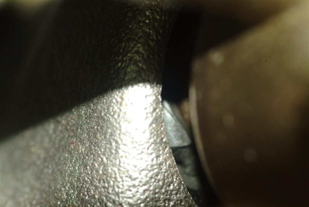

Message On JonPaul's Z we heard a vac leak but couldn't isolate the location. Seemed to be coming from middle/back of motor. We Connected smoke machine to plenum and let it fill w. smoke, we then saw a trickle of smoke coming up between the plenum runners but still couldn't pin point it. So we pulled the plenum and taped shut the openings into the combustion chambers. I then poked a small hole into the tape and let the nozzle of the smoke machine fill the combustion chambers - again we saw the trickle of smoke...
This time it was clear that it was from the fuel rail not seating @ the lower plenum...
