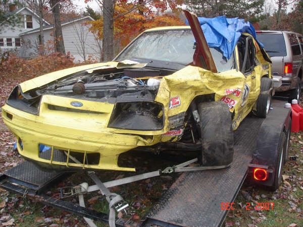

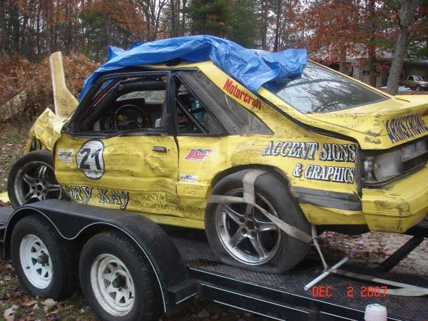

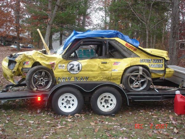

Message this wreck at VIR this weekend. full race cage saved him. no brakes at end of long straight 140 mph off track into tire wall.
he had rubbed a hole in a brake line over time and didn't find it. please check all brake lines circumferentially during pre-race/ track event inspection. don't count on a tech/mechanic to save your life....
