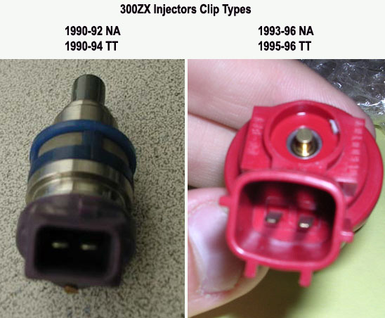

Message on our injectors is NOT on center like the connector expects.
If you force it, the connector will crack & break in time.
I order to use them w. out stressing them you'd need to grind off the external alignment tooth on all the injectors.
GM Injector:
Nissan Injector (older style on left):
