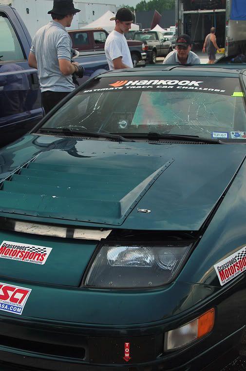

Before the last session, I double checked the Motec datalogs and was surprised to see the car was only running about 13-14psi of boost. I adjusted the boost map to try to get the car to run 20-22psi that it usually runs, and again we thought we would be able to make up more time with probably another 100hp on the car. In the rush to get the car out for the last session, I forgot to latch the hood pins, which ended our day early:
Ryan gamely went out with the cracked windshield for about 5 mins towards the end of the session but the cracks on the windshield reflected the evening sun at some critical corners, so Ryan was not able to set any good times.

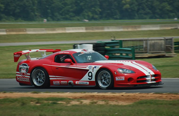

The cars that beat us were all serious factory built race cars:
Tommy Archer in a ALMS GT2 class Viper Competition Coupe
