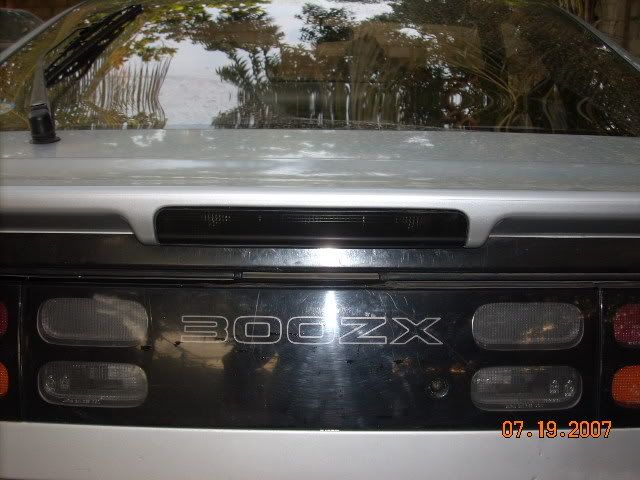

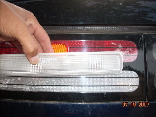

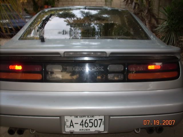

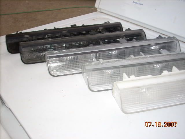

Message Some pictures of the 3rd brake lenses in 5 different shades.
But only 3 will be offered the clear one to match the superwhite z's the clear ones to match the 99jspec tails and smoked.Still experimenting with the LED setup

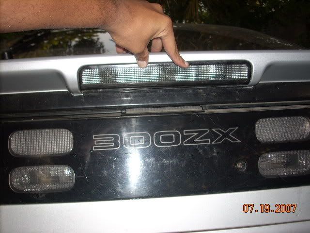

To match the 99jspec tails
different tint matches the reverse lamps.these won't be produced
Smoked

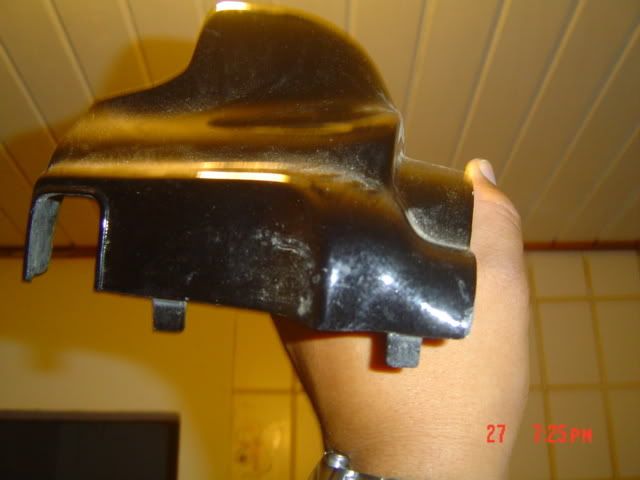

Next part on the to be made in plastic

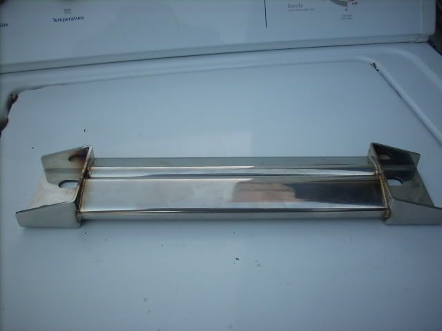

Also finally availale next month the lower tie brace for the coupes and 2+2 Z's .anyone got a picture of this brace for the convertible Z's ?and also of the gearbox bracket ?

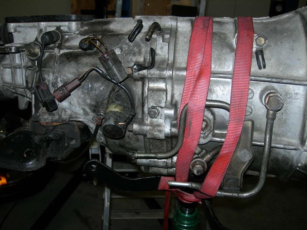

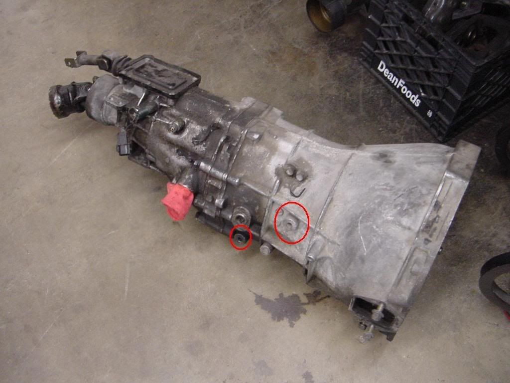

Thought I would post this picture sice most people don't know about the gearbox cooler system that came with the Euro Spec Z's
The cooler is located in the back and is oparated by an electrical pump.
for M/T off ->on 266 degrees
on ->off 248 degress
however the pump won't operate is the vehicles speed is less than 75 mph but for the automatic z's it is less than 6 mph
The mounting points.this is just a regular gearbox.the holes would need to be drilled to install it
