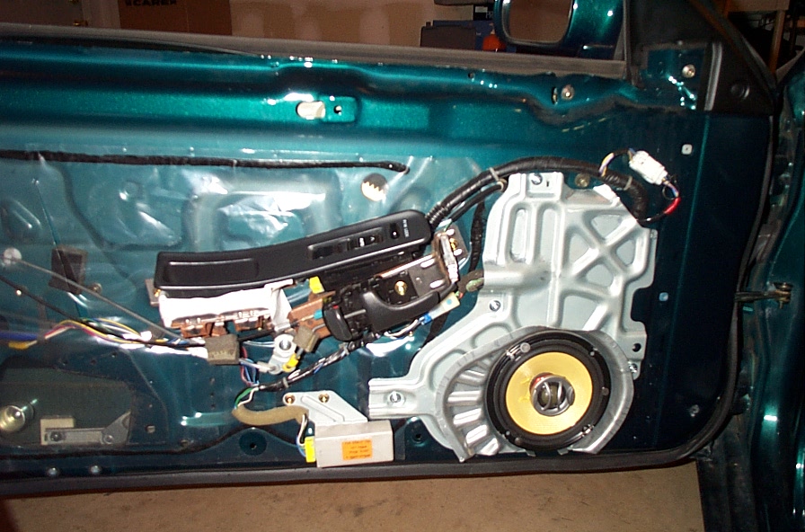

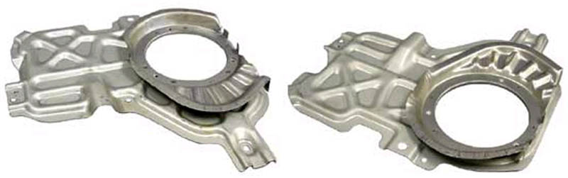

Message They place the speaker too close to the door panel and don't protect it. The OEM metal panels fit perfectly and they recess the speaker since they are not just flat plastic. They also have a collar that keeps the panel from getting smashed against the speaker AND it creates an enclosure for them.
I've done it both ways - but I prefer the OEM to any home made bracket I've see.
