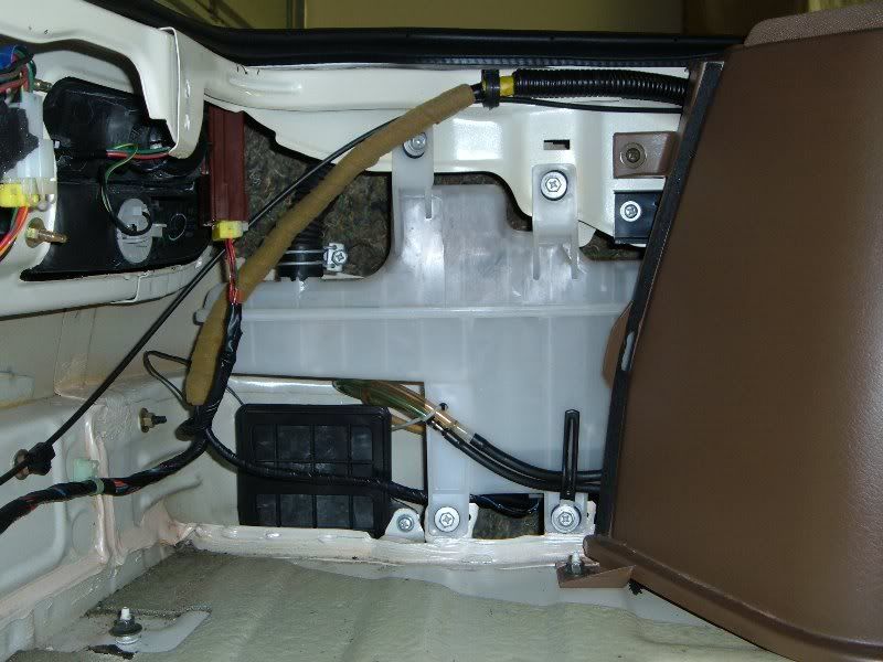

I had my washer bottle out and cleaned it out as good as possible given its myriad of baffles. After the reinstallation, I tested the system out to make sure that it was spraying fine and the connections weren't leaking.

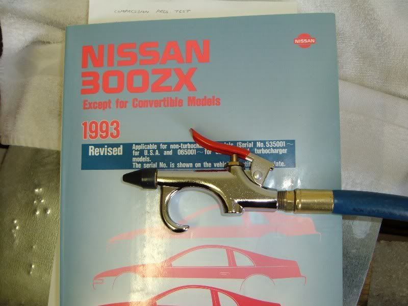

I disconnected the nozzle hoses at the Y connector again and attached a blow gun, with a tapered rubber tip, to my air compressor hose.
blow gun does the job
With the tip to each hose, I shot a couple air blasts of moderate pressure. Retested the nozzles and they worked perfectly.
And BTW, FWIW, when the washer bottle dipstick reads empty, there is really about a quart of fluid left. The WB is '+' shaped and the dipstick reaches only to the bottom of the horizontal portion of the +. Total WB capacity is about 3 quarts.
