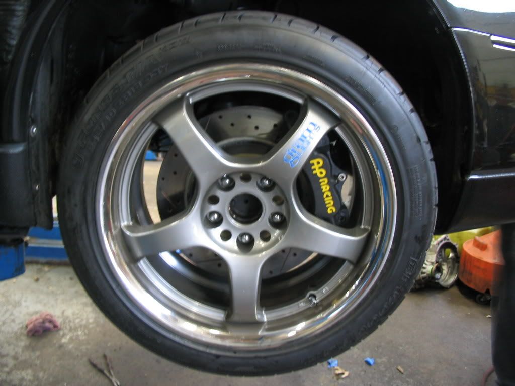

Yes..do it once do it right.. -
97modman(NJ)
10:04:35 03/16/07

installed them last year right before i put the car away
97modman(NJ)
10:48:51 03/16/07
They are leaps and bounds better than stock

I agree they are better than stock, but last I checked
Scotts94z32
10:21:20 03/16/07
It's not just a matter of 12.75 vs. 13"...

The rotors yes, the calipers not so much.
