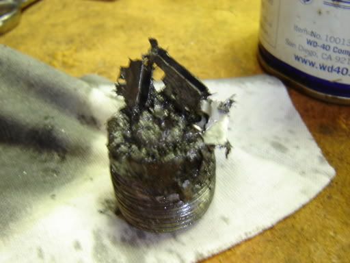

Strange findings when draining tranny. Any ideas?
posted by BCs300z
on December 31, 2006 at 09:18 AM
No Good! My transmission lost 2nd and 4th gear recently after i discovered this.
BCs300z
09:18:28 12/31/06
Well for starters thats alot of metal on the drain plug (n/m)
TTFairladyZ
09:27:06 12/31/06
Not really; "Brian drives a Black 1990 Twin Turbo coupe"
nixit
09:30:53 12/31/06
Mine is a 1990 as well with 160K+ miles
TTFairladyZ
09:33:46 12/31/06
This is out of the TT I just bought. Has 143K on it.
BCs300z
09:45:05 12/31/06
Syncro pieces. (n/m)
YugoBernie (NoVA)
09:30:37 12/31/06
thanks. guess I'll take it apart then & see what lays within (n/m)
BCs300z
09:46:29 12/31/06
Spring insert for a syncro, probably which ever gear was
spddracer
10:26:55 12/31/06
The clip is a dog for the syncros that
nissanguyz32
10:58:39 12/31/06
I Have had the same issue once... -
imney
11:52:38 12/31/06
Thanks very much to everyone for the replies
BCs300z
14:40:30 12/31/06
LOL, I just pulled the same out of mine...
outkaZTT
15:54:40 12/31/06
