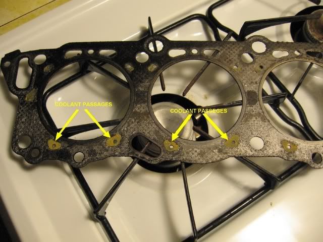

No. The part of my gaskets that are showing a yellowish
posted by WAGGZ
on December 16, 2006 at 03:56 PM
These small holes. Not the ones you pictured.
Coolant restriction through the head gaskets...
WAGGZ
20:59:45 12/15/06
i always increase the size of those holes in all
ztunerz
21:07:28 12/15/06
Its odd but alot of Nissan head gaskets on other cars look
twinturbopoweredz
21:33:17 12/15/06
yeah the KA are that same was for the 2 and 3 cylender area (n/m)
Halo Z
23:24:28 12/15/06
I would not fook with it. (n/m)
PennStateZ
22:01:00 12/15/06
I wonder why they are like that. I wonder if someone knows
upcominZ_(NOLA)
23:33:01 12/15/06
To improve circulation
NytWolf
02:09:21 12/16/06
Thanks for being here.
TT XTZ
09:59:23 12/16/06
Thanks, I enjoy being here (n/m)
NytWolf
11:25:06 12/16/06
I would bet those are there to help ballance the flow...
The-FActor
02:09:29 12/16/06
is done on purpose
lymon
02:14:57 12/16/06
Thanx guys for the info. (n/m)
WAGGZ
08:29:36 12/16/06
My tomei headgaskests match the size exactly
AzHeat
14:14:45 12/16/06
Correction, mine are slightly smaller than stock
AzHeat
15:14:16 12/16/06
Those are oil drain holes, not coolant. Check your
AzHeat
15:09:46 12/16/06
WAGGZ
15:56:29 12/16/06
WAGGZ
16:19:27 12/16/06
Which brings up another good point worth mentioning here:
DAYTONAZ
16:09:55 12/16/06
The holes that are shaped like a pear are also
AzHeat
16:20:08 12/16/06
I see
WAGGZ
16:36:21 12/16/06
