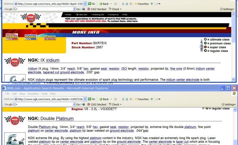

TwinTurbo.NET: Nissan 300ZX forum - Here is a spec match for the Iridium compared

to the current recommended platinum (5Bs)

Here is a spec match for the Iridium compared -
colocomp (Denver)
17:28:36 12/13/06
