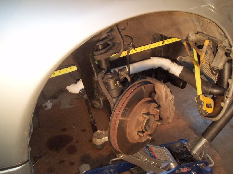

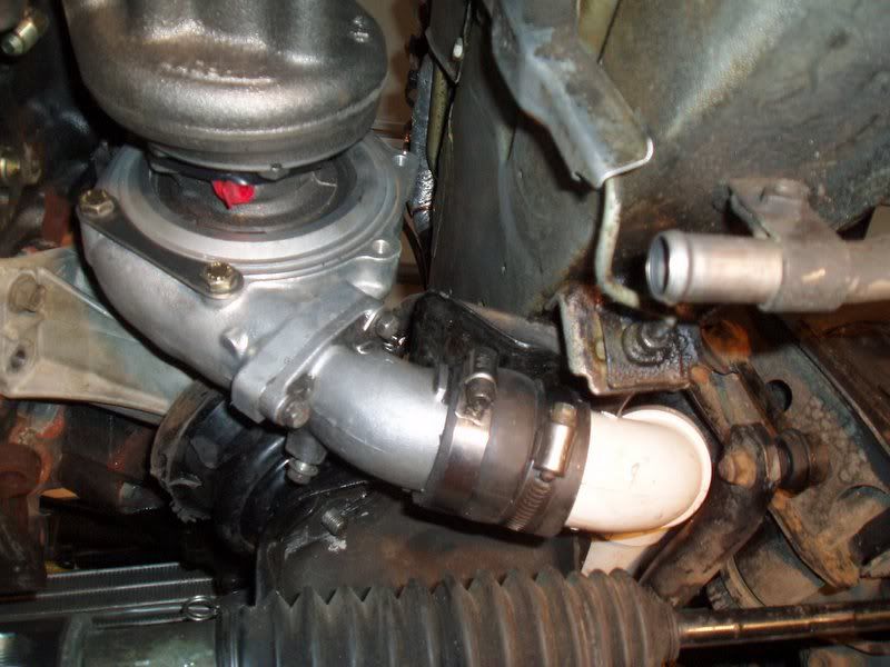

Everything with the Z32TT comes with trade-offs: performance vs. reliability...and money, cornering vs. ride comfort....etc. Concerning manifold design things are no different. The stock manifolds "fit" remarkably well...even with upgraded turbos, yet don't deliver on performance. The challenge has always been to find enough "space" in what is a very crowded engine bay to fit a larger, better-flowing manifold and still clear the steering shaft. If that weren't great enough feat, now try to fit larger (3 inch) downpipes that are straighter and clear the cowl.....and larger (3 inch), and straighter compressor inlet pipes that clear motor mounts.
This is all accomplished by putting a 12 degree tilt (15 degrees max allowed w/ BB CHRA) from horizontal on the turbochargers. An added benefit is better gating and port separation between rear cylinder. Next week my RS's with the TO4B compressor housings should arrive from Supra Killin' Antonio (Kong's idea)...to make sure they still fit.

Now as many others are moving to a 3" exhaust, the next impediment to performance is the intake. If you've ever seen the wimpy intake piping that delivers air to your turbos...the "lungs" of our forced-induction cars, it's amazing the car produces the power it does. Imagine doubling these 2" (3 sq. in.) pipes to 3" (7 sq. in.) and making them a whole lot straighter.

The 3" inlet pipes will get connected to cone filters in front of the compressors.

Intercoolers will be fed thru "underground" plumbing and enter from the bottom to be vertically stacked and exit straight into the the TB's.
