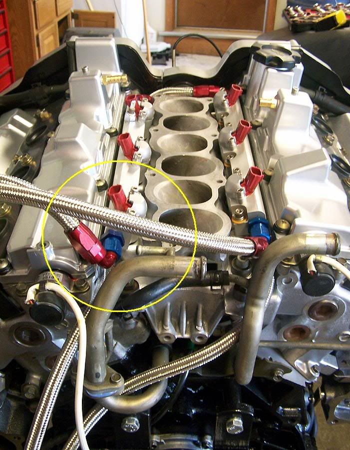

In Reply To 300 Degree fuel rail dual-feed setup & etc. > posted by whitepearlz on August 23, 2006 at 03:36 PM
Message the T after the fuel filter to the area behind the lower plenum. This would be somewhere in the area of the yellow circle in your pic no. 2
one of my fav engine bays
This would avoid the awkward T immediately after the fuel filter. Might be too cramped back there when the upper plenum is in.
Just a thought.
