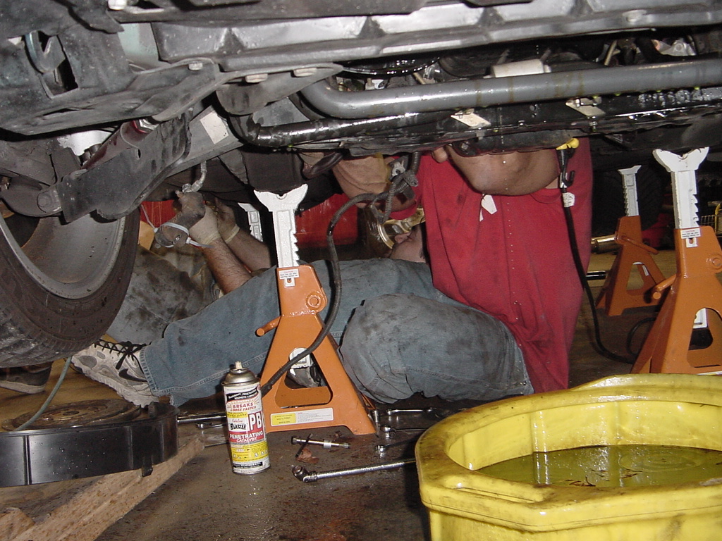

Spencer really into his work
This photo is clearly staged/Photoshoped. I have never before done a 60k...on my own Z. It was a little odd feeling honestly. Last week I half jokingly asked Kaz if he wanted to do it because he did the one on my 2+2 years ago.
Spencer was asking about a private medical matter...

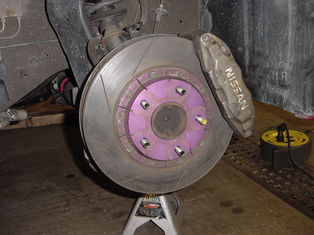

And finally - install some pink/purple 2 piece rotors & R32 calipers for Ashley so that she can track on something better then original stock pads & matching fluid.
The R32 calipers will fit behind stock 7.5" rotors w. a thin spacer (prob. 5mm is enough) or you have to grind away some of the edge of the caliper. However if you run the wider TT 8.5 wheels all around, they will clear w. out any extra hardware. Nissan really should have made this caliper & rotor size standard on the Z from the get go.
