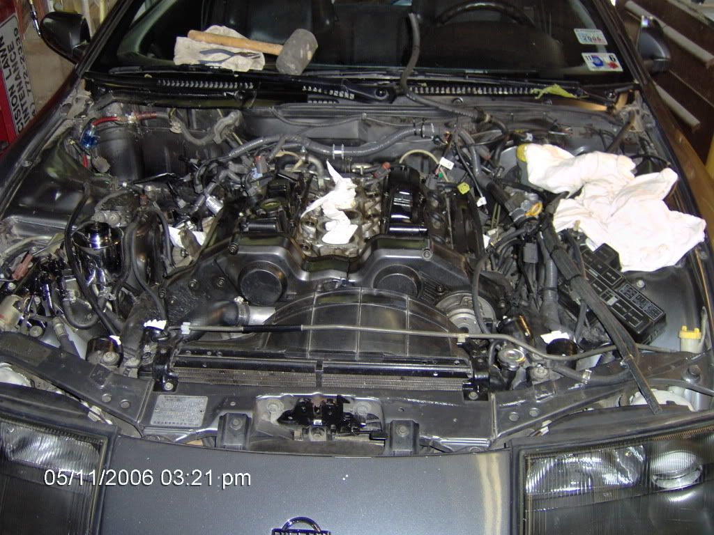

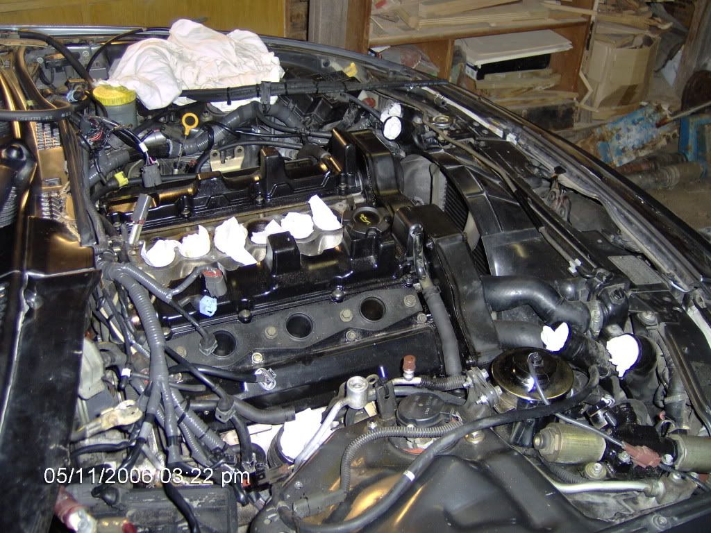

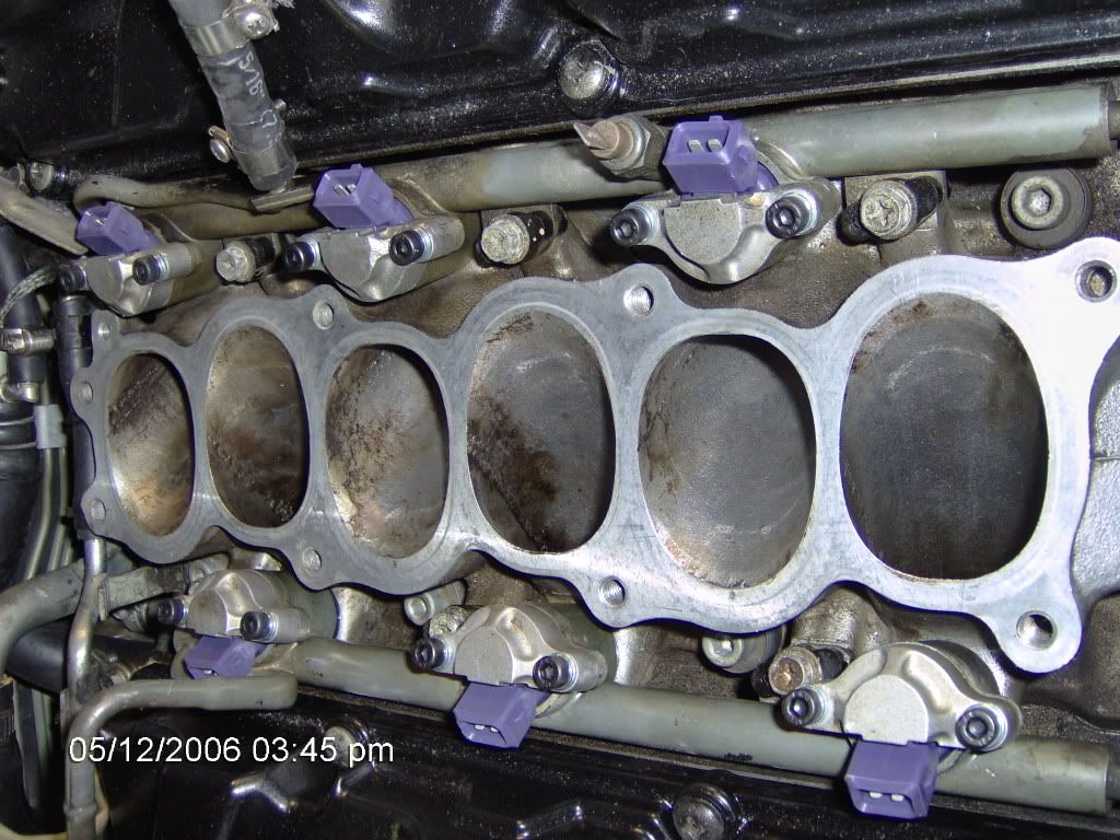

Well on to the install pics. This was my first SOLO plenum pull, and first with the engine IN the car... I must say, leaning over the car SUX...
This first pic is with the plenum off, and the fuel rail removed.

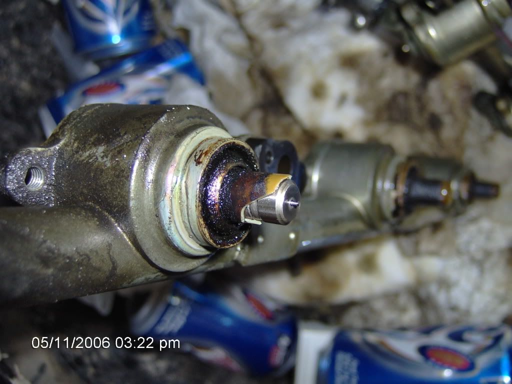

This pic is of one of the injectors... It was like this when I removed it... Also, one of the caps didn't even have an insulator in it. The cap screws were also mixed and matched. Whoever worked on/replaced these injectors was a DUMBASS.

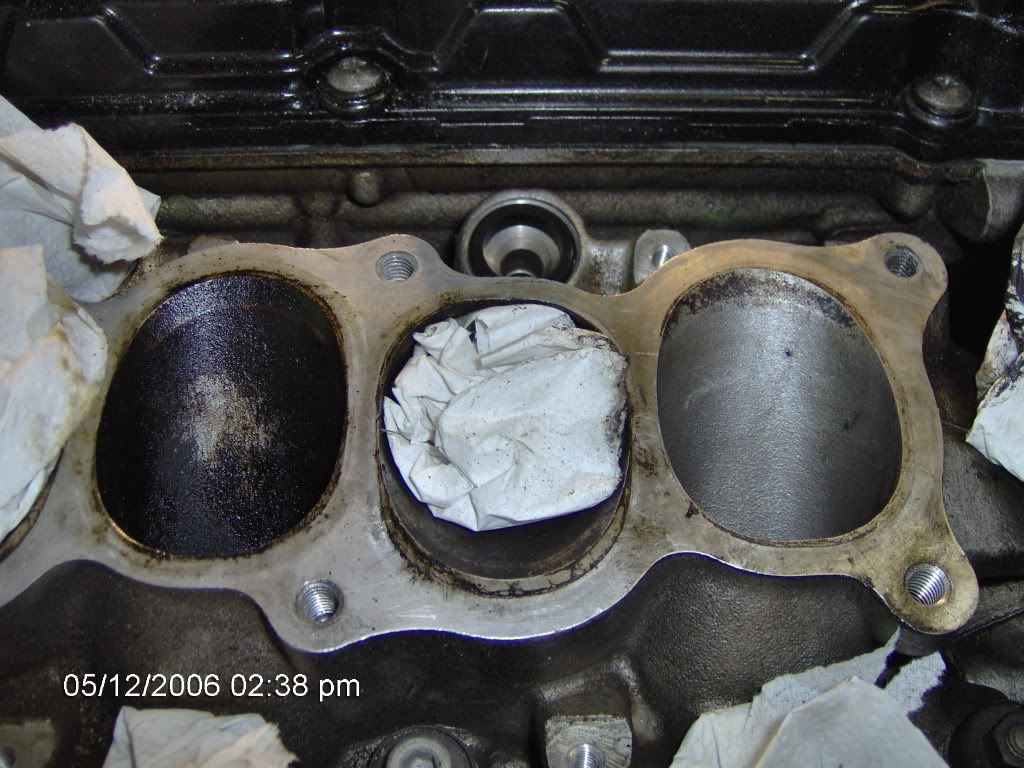

I'm not sure why, but the lower intake was pretty damn dirty... Spent some time cleaning it up, and getting the gunk out. maybe I'll idle/run better now.
After some cleaning, not perfect, but I didn't get a pic of the final...

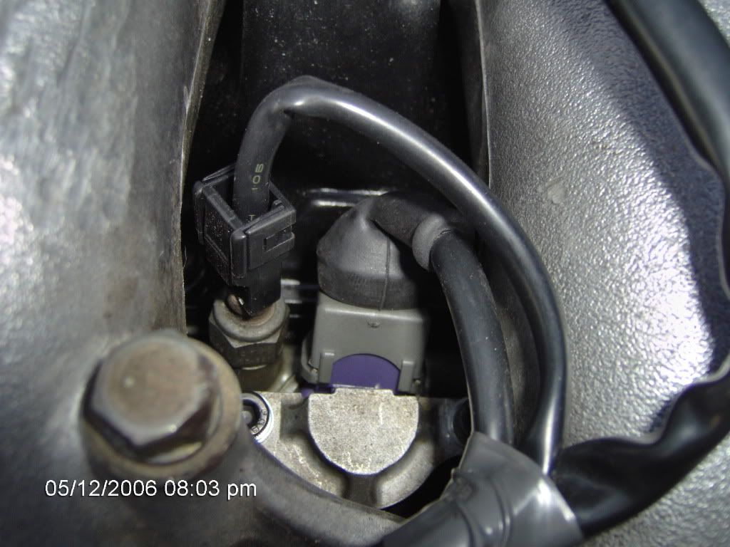

What is that blue-topped thingy under there???

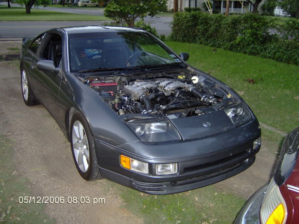

Well, I'm all done now... Put in my new eprom, THANKS ASH!! Re-set my AFC, and took her for a spin... Stumbled a bit at first, but smoothed out, and runs like a champ... BEAUTIFUL IDLE, smooth as my butt--err-- a babies butt ;)
I pondered turning the boost up a little, to like 14, from my base boost ffrom the Sp500's... I still may, just have to think about it. After all, Im going to SGP next weekend to have it Dyno tuned...
