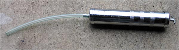

Subject What about the normal giant metal syringe-looking thing?
Posted by TT XTZ on April 13, 2006 at 11:45 PM
  This message has been viewed 79 times.
In Reply To No problem. Thanks for the support! posted by Ash's Z on April 13, 2006 at 11:28 PM
Message With the short length of rubber hose? That's what we use here. One more thing to watch out for is having the end of the hose that's inside the diff accidentally up against some internal part that causes the oil to run back out, making you think it's full before it really is. Make sure that's not the case.
