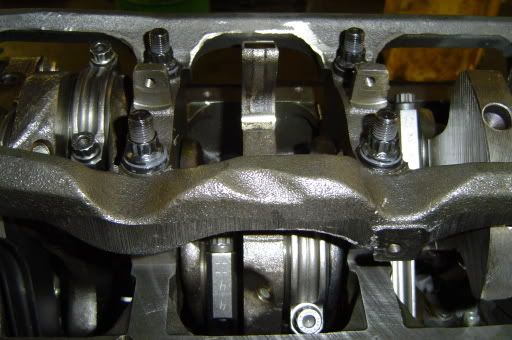

The bottom. . .
Image hosting by Photobucket
With each new day, the money vaccum renews it's hold on my wallet. . .
