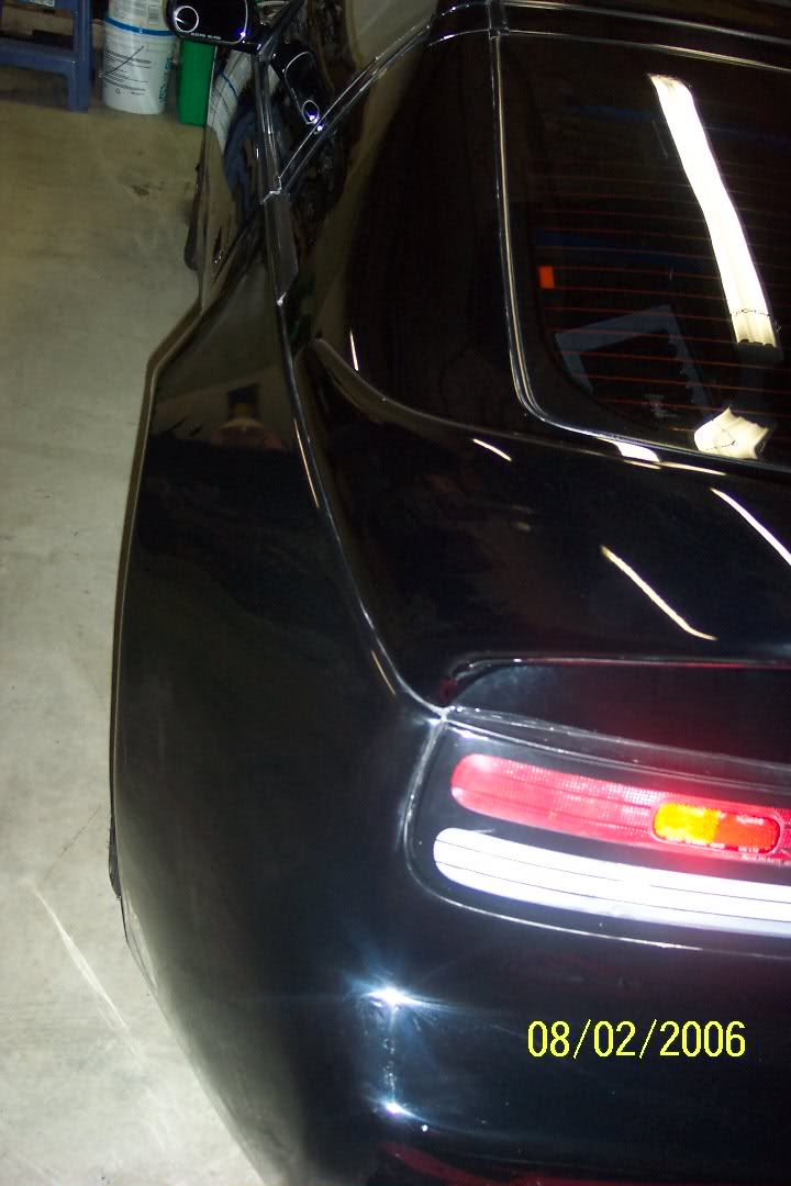

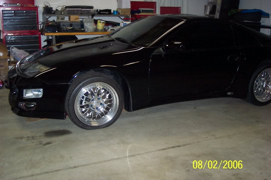

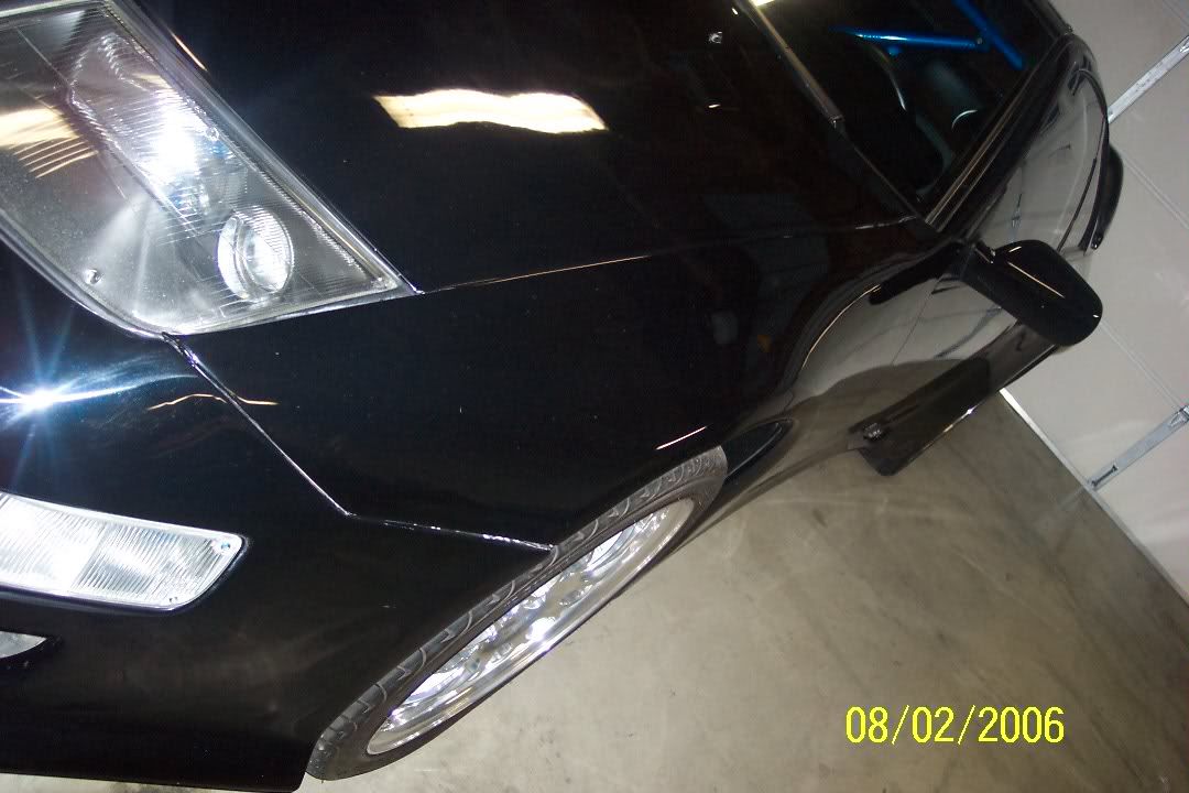

One of my favorite Z's of all time, snapped a few shots, while I was over at a buddy's house this weekend... The owner said it was really dirty, but to me, this car could be covered in mud, and I will still love it, these pics just do not do it justice!
My Z will be going into the body shop within the next few months to start its metal widebody conversion!! cant wait. Even though some of you hate widebodies, I personally love them.
Hope ya enjoyed the pics!
